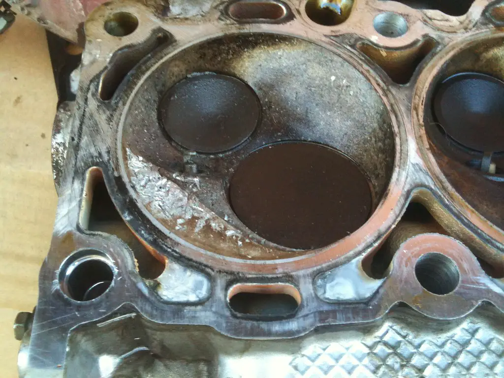

Yesterday we stopped taking apart the motor. We got as far as taking 1 head off (passenger side)...
We found this on the head over 2 cylinders..
2 of the pistons look like this (broken). And one is filled with water after sitting for the 3 weeks or so.
Yes.. thats the ring you see.. We didn't even bother to take the other head off.. We are looking at what a used motor is going to run since rebuilding this motor ain't cheap.. Also, thats a bunch of water in the other cylinder and it looks like that water has been there since the truck was parked, about 3 weeks now.
btw.. this is a 4.7 v8 out of a 2003 dodge durango..
