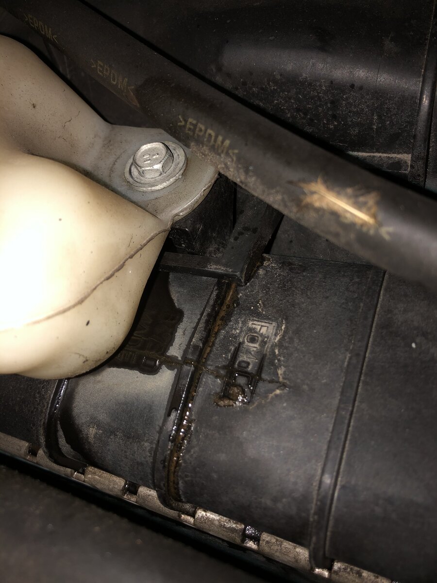

You guys had to talk about Radiators! On my way to work this morning I got a whiff of coolant. I now see that radiator number 3 has split the top tank. Well, at least this one lasted 11 years!

My first ever plastic tank was found on my '78 Fiesta, bought new. Owned two more after that one, radiators were the only problem encountered, in addition to water pumps. I always suspected that the rigidly-mounted radiators were being flexed by the unitized body parts up front, causing early failure, but never bothered to contrive a remedy. Two of those cars were sold still running well with 200,000+ miles on them. 1.6L English "Kent" engine, substantially well-engineered.
Probably about 130,000 miles on this one, it has had a very slight drip from where the aluminium meets the plastic for about 5 years, And I have been running the £16 cap instead of the factory 20 since then.
I bought the truck new in June 2006, rad replaced under warranty in 2008, and again in March of 2009 Just before the warranty ran out, so I’m ok with this. Just deciding about what brand to go with
Maybe around 100k is when they seem to go bad. Mine was replaced at just over the 100k mark.
