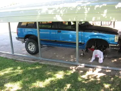

going to put my shackles on tonight, so i thought i might soak them while i was out geting my new used 31x10.50 15's that i got for $40.00 ! :D all in all i have my 2in. skyjacker springs form summit coming and the home made shackles for a 2in. all the way around them ill put my 31's on, so i thought i'd start this thread ...
got the lift on , got a tad over 1 1/2 in. out of it, now all i need is the springs , and ill be good to go...

started on the front....got dark so i stoped ...
got the tires put on the rims, put the back ones on.....
so i got them in today, got them on and love them ! look sweet ride good , just am 100% happy with the hole thing !
