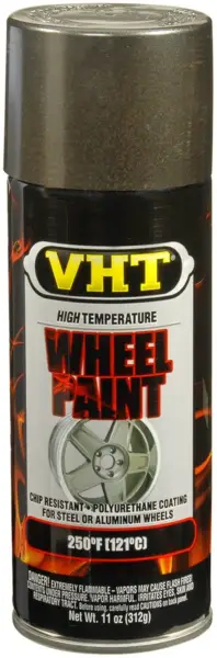

The T-case looks good in the aluminum-silver, but I wouldn't paint the engine block that color, plus in my experience silver paint does not hold up very well to oil, gasoline or even strong cleaners. I'm leaning toward the darker metallic gray VHT (Very High Temperature).
This one is good says it's good to 250 degrees F. PN SP189 Graphite Gray
This one is good to 360 degrees F and it says "Duplicates Original FORD Color" Ooooo.
Nice, those will work. That top one is very close to what I painted my TC, the can cap looks that dark. It just wasn't a high heat paint, but on hand to try on the TC. I liked it, and then did my bare trans case that I had just cleaned. I too have lots of spare paint etc, it's time to use it up if possible.
