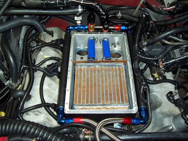

I finally finished installing the intercooler core with connections and performed a leak test.
During the five minute test I observed no leaks at any of the connections which was no surprise since the system is not pressurized. The sound of the intercooler system reminds me of coffee perculating next to a running refrigerator. The perculator sound comes from the input/output flow in the coolant reservoir. The intercooler pump motor is at least twice as loud as the Aeromotive fuel pump.
One advantage of my "open" system is I can turn the pump on and off for dyno testing and not worry about the system exploding. If the coolant gets hot enough to boil it will just vent into the unpressurized reservoir. That way I can easily measure the IATs for cooled and not cooled during performance testing.
She looks pretty clean!
If you get chance could you send me this picture in high resolution?
How does air get to the back two cylinders? ? Looks like the core support blocks the off? Does the core sit flush on the bottom of the case?
photo sent

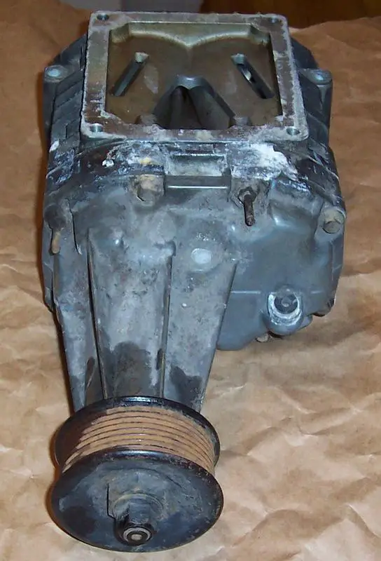

Ronald, I am very pleased with the intercooler installation so far. I'm anxious to find out how everything works but have decided to clean up the M90 and replace the coupler, snout seal and oil before installing it. The paint was peeling so I applied paint stripper to the outside today. I'll start brushing it down to bare metal tomorrow. I'm not going to paint it.
depth of core
Good question! I asked Ronald the same thing. The dept of the core is less than the height of the manifold by the height of the stop. That was one of the issues that made it difficult to find a core. It had to be the correct depth to allow airflow underneath and cover the blower output opening. It was a trade off between cooling capacity and airflow restriction. I think the assumption is that the entire manifold will be pressurized during boost and the air will flow into which ever port is open when an intake valve is open. If there is restricted flow to the back cylinders it will be difficult to determine with my PowerFlash because both banks should be equally affected. If there is a large flow difference the PCM may detect it and set a misfire DTC for those cylinders. I plan to monitor the spark plugs to see if the rear plugs show any differences compared to the front plugs.
There is aprox 7-sq" of open area below heater core to supply back 2-inlets, as support is only as thick as the heater core, with void below.
Figured there was.from the pictures It looked like he rtv the core support plate in and it went all the way to the bottom sealing off the rear section.thats a pretty big looking core also, should work well:salute:

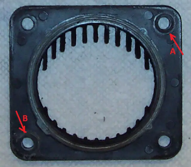

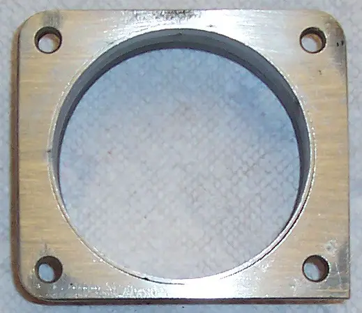

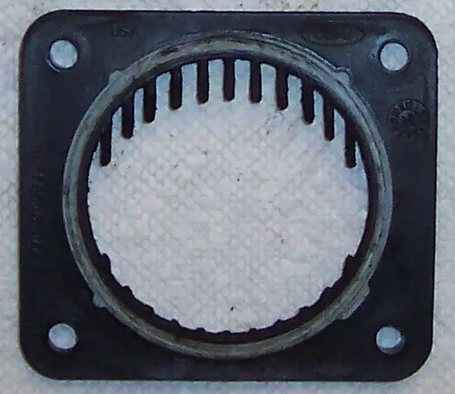

"comb" gasket

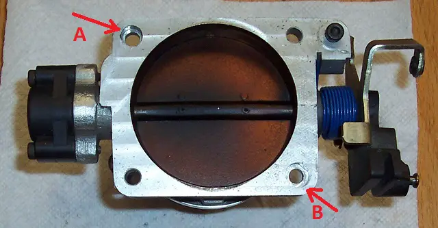

My 75 mm throttle body output port inside diameter is about 3/32" larger than its associated tube adapter.
Therefore I need a fairly thick tapered gasket to "soften" the transition. Remember the stock "comb" gasket that fit between the throttle body and the upper intake manifold. I found my old one in the storage room. It's about 5/32" thick and has protrusions that match my Ford prototype throttle body recessions.
I'll grind out the "comb teeth" and enlarge and taper the inner diameter to match the two different bores.

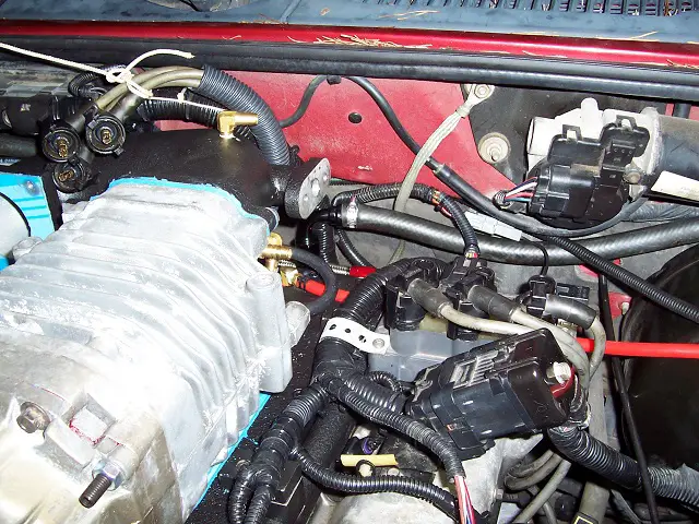

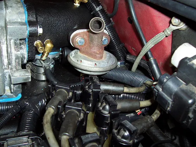

EGR issues
The Banshee kit is designed for the EGR valve to be mounted on the plenum.
In my case I felt it was too close to the spark plug wire and engine wire looms.
Even after turning it upside so the cooler diaphragm side was near the wiring I decided it was too close.
I was surprised that I could still get access to the driver side intercooler hose connection so I took it loose to all routing the loom below it (instead of above). Then I reconnected the intercooler hose, did a leak check, and installed a loom clamp.
I think I'll still mount the EGR valve inverted.
