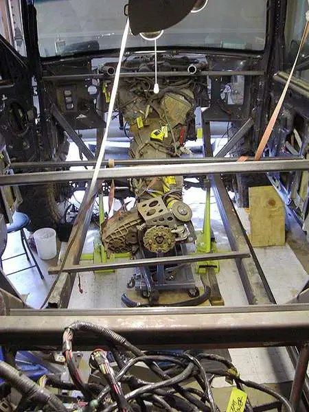

What do you mean now what? Kidding, well hopefully this weekend I'll get a manual 1350 t-case from BLEE for the doubler. I'm trying to hold off on building the cage too much because as it is, I'm enjoying the ability to walk inside my Explorer -- think of it as a small walk-in closet (with an engine in the middle).
Just leave the floor out of it and put in just enough support for the seats and to keep the body from folding up like a taco. Then you can just duck under the body and strap yourself in.

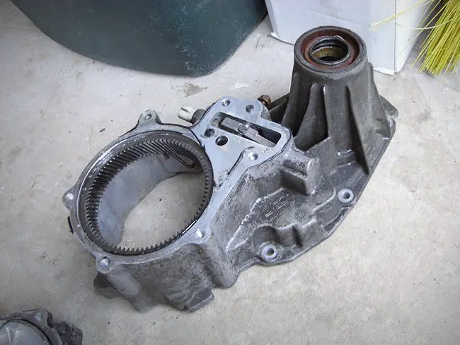

Today I picked up the BW-1350 (from BLEE) and tore it down for the doubler.
The case half that needs to be cut:
Planetary set:
Its not required to take the planetary out but I wanted to replace the input seal (cauz hot tanking would have destroyed it anyway so I removed it) and I wanted to keep the planetary set and bearings clean during the cutting process.

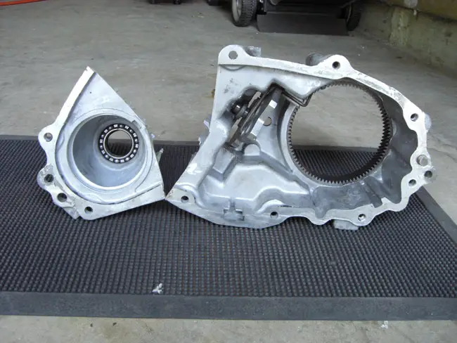

Got the casing back from the hot del tank.
Casing cut in half -- only took about 5-7 mins with a reciprocating saw and w/o much pressure on the saw other than to keep it steady:
Mockup with one adapter plate dimension (3.25"):
Casing with all internals required (except for the pickup/filter for the oil):
Overall, the doubler will add about 8.75" do the drivetrain.
A section of tube has been ordered and sent to my brother. he will turn it on a lathe so that the faces are exactly perpendicular with the tube's center axis -- this will be what goes in between the two cases (with some plating and whatever else).

Very nice, so are essentially building your own doubler or are there parts from a machine shop in there?
I'm very interested in the doubler and these pics are great.
So where is the back half of the front case coming into the picture? Is it cut the same way as the front half?
The back half of the front case is thrown away -- you dont need it because the front half is going to bolt up to the adapter plate (with some RTV to seal it up).
