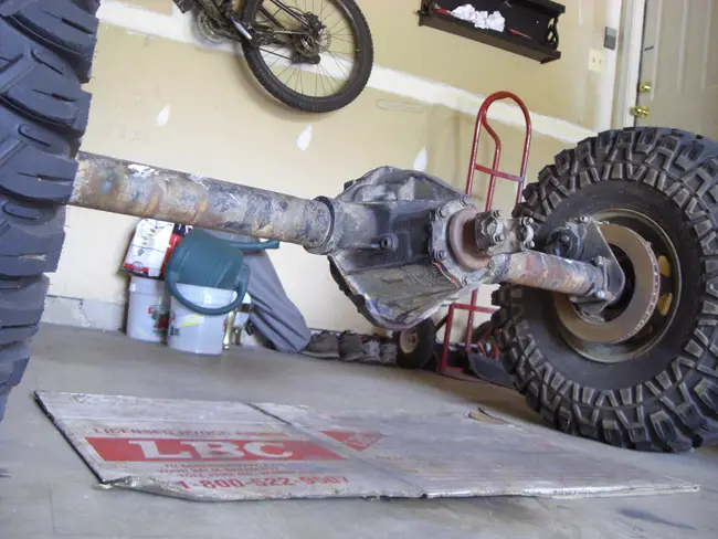

Akaay so while I'm waiting for some cold rolled steel for the doubler to arrive, I thought I'd work on the rear axle.
So first on the list was to remove the old spring perches and shock brackets:
Then it was time to shave the boat anchor ... I mean 14-bolt. So after a bit of eye-ing the cut, I taped it up and removed the internals:
20 mins later:
The offending piece:
Traced the sliced piece to 3/8" plate and used the plasma cutter to make the replacement plate:
Then I spent about 20 mins preheating the housing and did a 4" pass with the MIG (then reheat, then another 4" and so on..). The inside was also welded with the same heat, weld, reheat process.
I slowly let the housing cool (over an hour) by applying heat to the cast housing at greater time intervals. After it was cool enough to keep my hand on it for a few seconds, I grinded down the sharp edges:
I gained about 1-1/4" in clearance. Tomorrow I'll shave down the ring gear diameter by maybe 1/4" of an inch and modify the cover.

can we get a picture from a little more distace to compare 1st or 2nd picture to current.;)
Thank you:thumbsup:
I'll remember to take a pic of that tomorrow.

And Stic-O's request:
I was able to drill and re-tap one of the bottom diff cover holes but the other was just too close to the edge so I drilled and tapped another about 3/4" above the original. Tomorrow I'm going to try to work on the boat side doodas because the links are going to attach to parts of the boat side rails and I need to get crackin' on the links.
