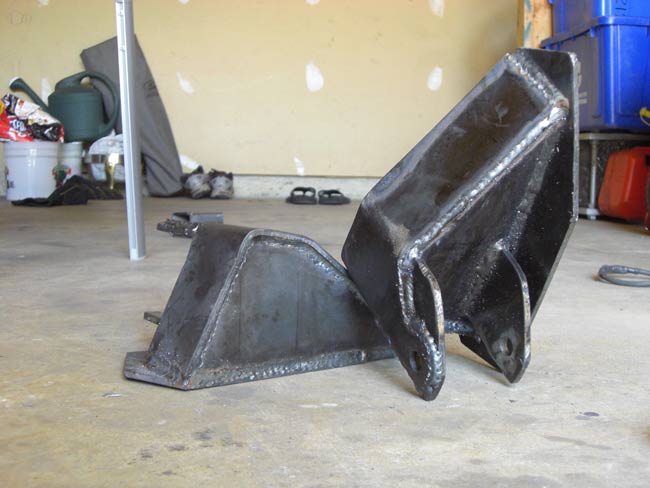

Made some rear link bracket at the chassis end. Inside each bracket is a 2"x2" square tubing for internal structuuuuure.
Deees iiiis how it will look like on the chassis:
Its angled out about 10 degrees. I'll burn them into the chassis once the rear links are made -- which will probably be about 38" - 39" in length (the lowers that is)

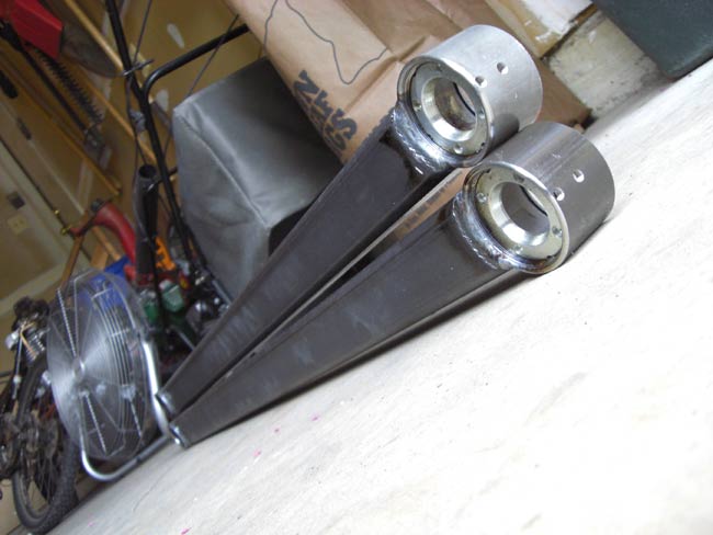

Rear lower links:
Broke out the plasma and made some tabs, and then it was time to mock up the rear links to ensure the Rubicon Express SuperFlex was horizontal:
Welded in the chassis mount:
And this is the link angle from the bottom:
And from the top:

Most of the time I sandwhich the steel with two sets of steel clamps and whack one half of the clamp with a hammer after heating. But on that one, I just welded the center to the top and bottom plates, and then a few blows with a hammer (the steel was hot enough after welding). Then a set of clamps were used to close the gap between the ends of the plate and the other surface its going to be welded to. Yeah its crude and I feel like I belong in the stone age using that method but it worked for that ;) I really need to build a brake but I'm a little tight on room. The bent plates are 3/16" thick so its not as difficult as 1/4" (the tabs where the link bolts to).
