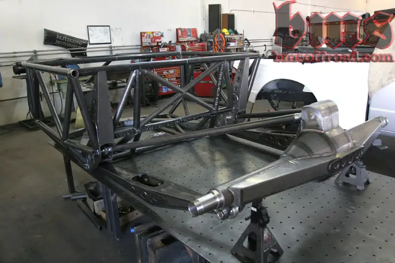

On my cage (when I get around to it *sigh*), I am going to use as little and as few bends as possible. I'm borrowing this principle from the racing chassis domain (baja, NASCAR, old F1, etc...). Example:
(The bottom half of a Blitzkrieg Motorsports chassis).
triangles are your best friend, triangle is the strongest shape because all three sides support each other.
Bends are for the A, B, and C pillars, everything else = triangles and no dead tubes

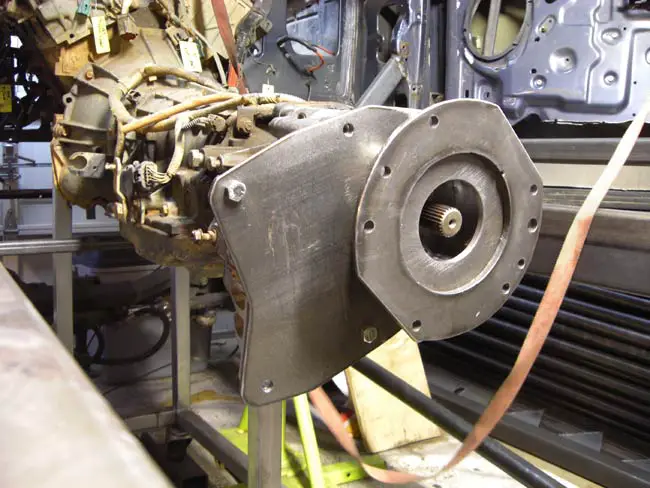

Made a compas for the plasma:
And traced some arcs from the drilled 3/8" plate:
Finished one end of the adapter:
Das is all for now, gotta go to the airport.
We're not worthy!
That's some absolutely amazing work you're doing. Plasma is definately next on my list of stuff to get.
Thanks!
This is the plate on the doubler, of course it actually goes on the other transfer case but the pattern is exactly the same.
Cut the other side of the adapter:
(added two small holes below the main shaft so any fluid that makes it into the adapter from splashing drains back into the doubler)
And this is what the stack of plates and a cylinder is going to look like:
You planning on flat belly?
Yup! I'm going to clock the doubler's adapter about 15 degrees so that the transfer case up above the bottom of the frame rails.
Tack welded and mocked:
For anyone building one, "clocking" doesnt really help because the bottom near the center of the transfer case remains the same distance even during clocking. So looks like I'm going to level out the drivetrain (from the stock X number of degrees) and as a last resort, move the whole thing up if the doubler and the transfer case still does not clear the bottom of the chassis.
