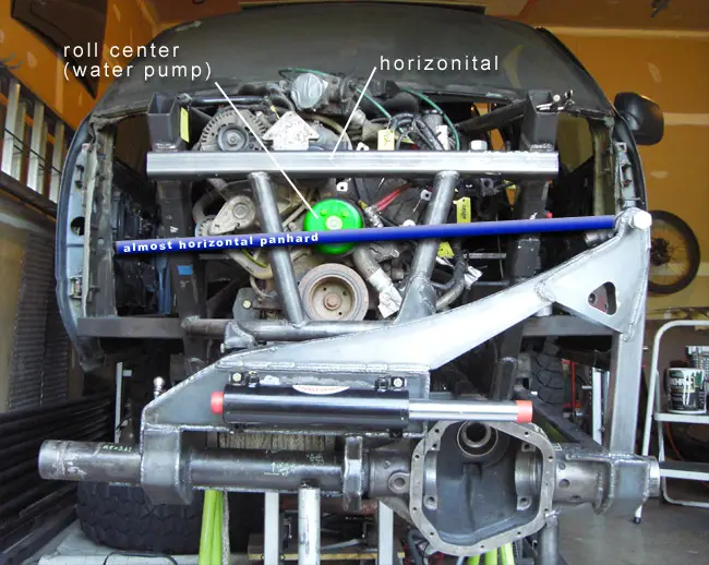

I've actually got some tech questions for you, is your trac-bar (front) going to be flat or close to it and whats the roll center going to be like?
I was going to make the panhard horizontal but since the vehicle is biased for mostly all droop (no desert running), the panhard should be angled up a bit on the axle end (and down on the chassis end). As for the roll center, the goal is around the water pump -- assuming the center of the unsprung weight is at about the top of the transmision bellhousing. Roll axis will either be horizontal or slightly higher on the back end so the vehicle slightly noses forward when its climbing up and off camber as opposed to leaning backwards (from the driver's perspective). So the rear roll axis will be slightly higher than the front.
Coolness, gonna make extra holes on the frame side to give you options as far as raising or lowering the trac-bar?
Thats a good idea, i"ll look into it -- thanks!
