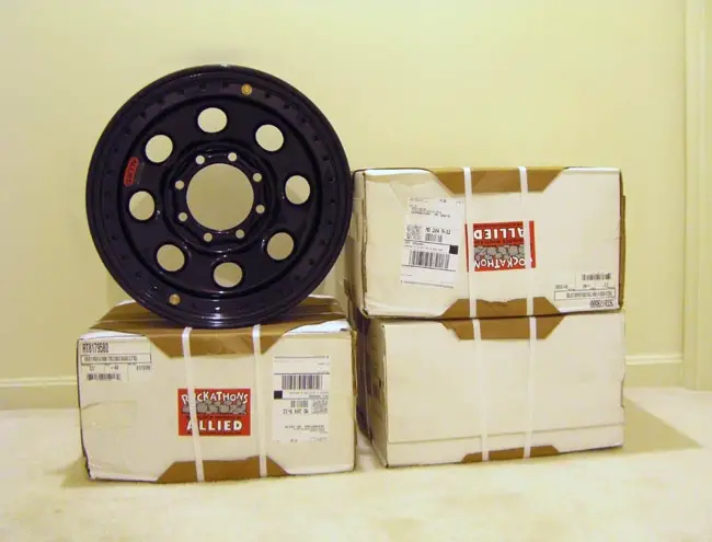

Some Rockathon beadlocks came in today -- 17"s for compatibility with either Iroks, Creepy Crawlers, or Krawlers (way to name tires!):

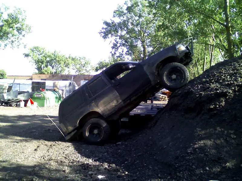

my tranny is usually pretty dependable, but it went out when i did the following.....
so i believe that is about it's limit.
we run a C4 in tom's buggy (major rock from werock)..and do MUCH steeper...just seal the dipstick at the tranny...and add another quart...never slips..nothing else done to it..
I've had my explorer EXACTLY the same angle suck air...now(did) run an extra quart in it..no problems!!

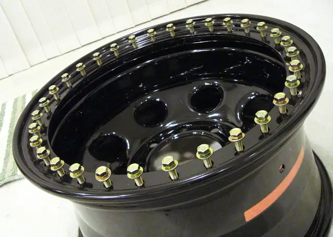

EDIT 2 -- finally got some time to play with the camera to take low light shots. A 32 bolt beadlock extravaganza:

Send me those beadlocks, i need to see if are heavy..
