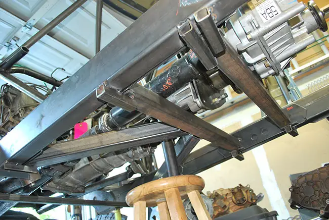

Some sort of a "K member":
Bars snake through some of the notches on the transfer case and doubler (with about 1/2" clearance top and side).
Drivetrain will be another ~3/8" of an inch higher at final position.
Mocked up more tubes - with one vertical (on each side) bracing the "K" against the upper tubes (should have enough room for shift linkages and so on).

Of course you can, truck over a set of end-mills, a Bridgeport, that bunny suit, and I'll put you right to work :)
I feel like a 4 yr old looking at space station blueprints. :p:
Corvines james t.. freaking corvines. Its like trying to make spaghetti from asphalt, or a dollar from fifty cents, holy freaking corvines. And remember that one time our parents sent us to space camp, and our "mentor", well yeah - that corvine incident.. :confused:
wait, does that mean IZ i9snt building a space station?
i was pretty damn sure we were talking about something capable of interplanetary travel in there some where

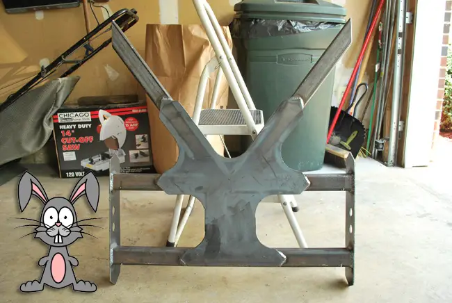

Got most of the whatever it is done.
Resemblance
The Miller welder and I were just wasting time, let the hours rolled by, doing nothing for the fun, a little taste of, you know, the good life:
Welds look awesome!
