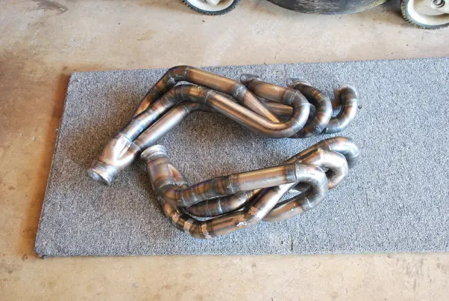

Been working on the headers for the past week or so after work/class.
Looks good, keep up the good work. Any sound clips with open headers?

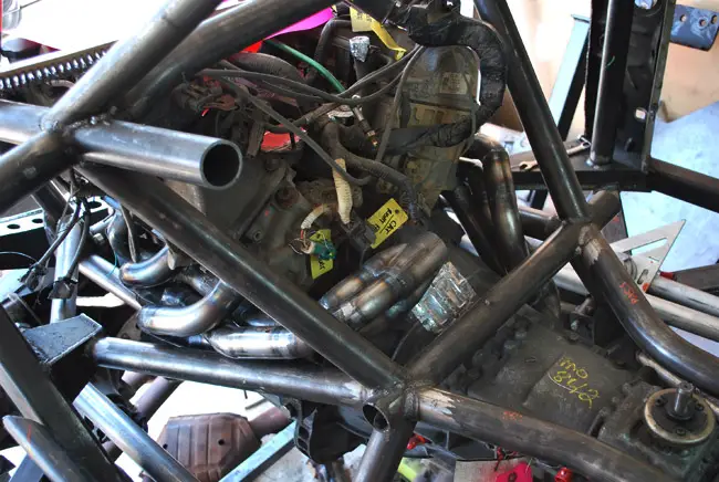

I ended up going with a pair of V-band clamp thingies because there's not enough room to snake the passenger's side header between the cage tubes and the transmission with regular exhaust flanges.

I actually like those clamps. Neater installation, and instead of sealing w/ a gasket and 3 bolts, it's sealed all the way around. This will be very cool once all done!
Simply six sick silver snakes snarled. LOL say that 3 times fast. :p: Looks good, man. Hoping for some audio soon!!

Man, I gotta get a better welder, that's beautiful.
Get a better welder, or become a better welder? Kidding, but I know, some times skill can only get you so far, then you need to spend the $$!
Yeah, I've got a harbor freight 110V 55A stick welder and a Lincoln Weld-Pak 80A Flux core. Both do good work, but nothing nearly as pretty as this.
