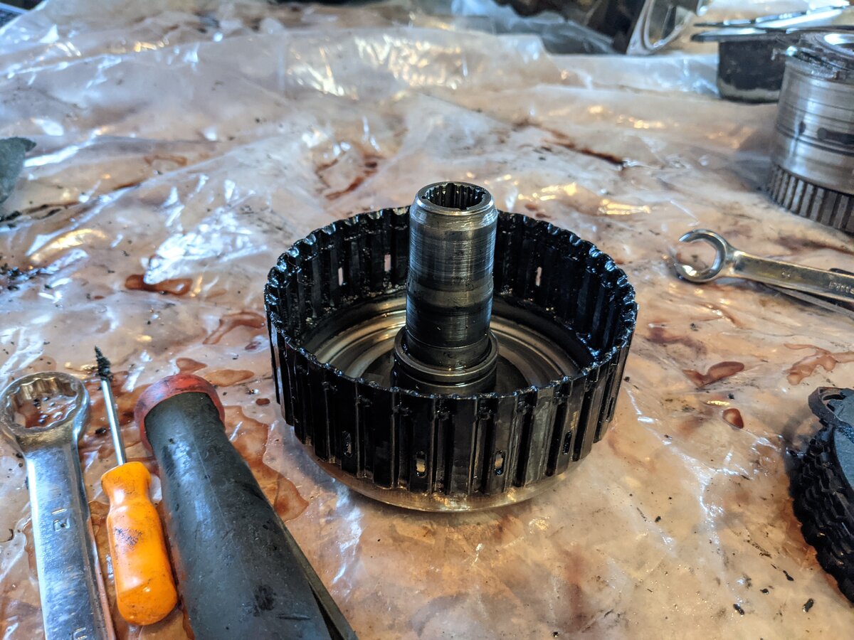

Well I got the transmission torn down today. Ive been using the Transmission Bench guide videos and they are great!! They go over every detail and verriant while also naming every part as they work on it. Can't recommend it enugh for anybody new to transmissions. The transmission came apart no problem, but ran into a few surprises. For one it has definitely been worked on before. But first, thought I would show off my makeshift workbench.
I took a sheet of plywood and edged it with some scrap wood to make a table that can hold fluids. 2x4s under it for support
Threw some plastic on it and used that as the bench.
I started pulling stuff apart. The whole pan went fine, but found some damage to the center support bushing. I have not checked out the matching edge on the planetary gear assembly yet, but I now see in the back of the photo that it does not look great. I'll do a better check later.
Quick photo of after I pulled everything out of the case
The direct drive clutch pack has definitely seen better days. You can hardly tell the frictions from the steels.
Upto this point I had guessed that I was not the first one in the transmission. There were a few things off, like how the anti rattle clip was missing, but when I pulled the clutch pack out of the forward clutch I found this metal disk in the bottom. That can't be factory.
I also found some scattered rust on the forward clutch. Nothing terrible, but it has definitely been exposed to weather.
I still need to clean everything up and do a better examination of everything, but it didn't look that bad inside. Nothing catastrophic. For what it's worth many of the berrings near the direct drive clutch had some material in them from the clutch itself. A bit crispy when testing them. For as cheap as they are I will just replace them while i'm in here.
Looks like a few hundred more tops, but it will be great to have a like-new transmission. Hopefully I will be able to go over the engine like this within a few years. At that point I will have had my hands in just about everything on the truck. I have not had to do any repairs in months now, but it will be great to have that number possibly reach years.
I also think I found the reason of the direct drive clutch failure. The inner seal on the piston was completely missing! Guessing that caused slipping and thus heat. There was a lot of heat on that clutch. The outer seal was melted out of shape and the whole drum was discolored. Ill post some photos lator. It does not look damaged, but was definitely overheated.
Hopefully I will be able to clean everything up this weekend and get a final list of replacement parts, but will see how the weather behaves. Don't really want to be doing this if it is only 45 out.

Good progress there. The damage looks moderate, the big worry should be the main hard parts, not the clutches, bearings, or seals. It does sound like someone messed it up working on it the last time. Missing a piston seal is a huge deal.
Keep the parts in order as possible, clean the main stuff, discard all frictions and steels. Get the new bearing kit(nine in it I think) and keep the old ones where they went until you have the new ones to swap out. The bearings are not simple to identify to location, many look very similar in dimensions.
Do you have the main trans tools yet? You will have to have the seal installers, and a piston compression tool of some kind. I haven't found my box of tools for many years, which is part of why I haven't begun my 4R projects still.
I would suggest replacing the direct drum if it doesn't look perfect, that is a big weak link. Inspect the one way clutches very well too, and clean everything fully, to perfection. Any tiny particles can eat up bearings, and any clutch or wear surface.

It (so far) does look like most of the damage is the bearings and bushings. The main clutch drum is definitely discolored and I do plan on replacing it. The rest I just glossed over as I didn't notice anything yet.
Definitely keeping things in order and will clean everything well and go over them again before placing my parts order. I've been keeping things organized. Seals with assembly's, assembly's together, roughly in order on the bench. That shouldn't be a problem. I have been keeping the bearings in place for the time being. I will be getting a new barring pack.
I haven't ordered any tools yet. Like I said I have been going along with the Transmission bench video series and in those videos he shows you how to make a piston press with some scrap wood so I did that. It worked quite well. I have looked into the reassembly part of the video and he shows you how to do it without using special tools, but I might grab some of those seal tools.
The mechanical diodes seem fine to me. They don't have the crunchy feel that some of the bearings have

Very good. Use up a can or two of brake cleaner, blast anything well that has crevices etc, that you cannot see or get to. The rear drum(direct) is suspect for warpage and wear on the surfaces that the other parts ride against. The direct should be replaced unless it comes out of a perfect condition trans, known decent mileage etc. I anything doesn't look great inside a 4R, change the direct drum, the $60 or so is worth the money to gain the best possible part. Sonnax makes a direct drum kit that is super expensive($650), but it's for high power and includes other parts, and replaces the weakest link(the connection between the direct drum and the stub shaft(they make it int one part)).
Which "...main clutch drum is definitely discolored...", the reverse or forward drum? The front one is the reverse drum(with the mechanical diode), and the one right behind that is the forward. I like the Sonnax Forward drum top replace that one, theirs is much stronger, and holds two extra clutches. Sonnax makes two of those forward drums, don't buy the lower cost one, that one had(may still have) an issue with the inner retaining plate not having full tooth contact with the drum. The better one was about $185, the pictures show it as black instead of silver, and that's the best choice if you need a new forward drum. I have all of those Sonnax parts, from plans to build about three 4R's for my projects. I haven't used them yet, but they are very good parts for sure.

Sorry, by main drum I meant to say direct drum. Will definitely be replacing that. I've been going with Sonnax parts where I can. Getting my birring kit from them and have there Sure Cure Kit to go in as well.

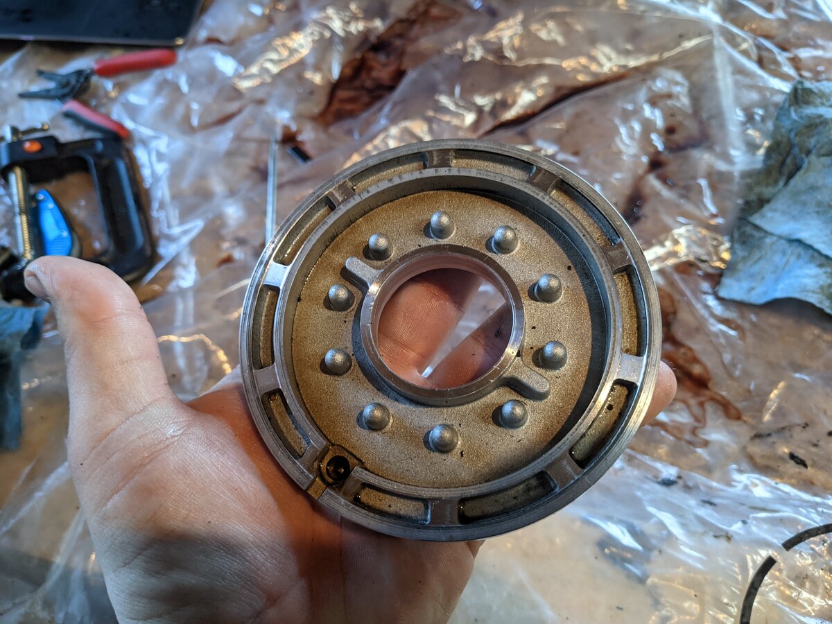

Well I did actually manage to get everything cleaned up today. Didn't really find any more surprises.
Here is a photo of the messy direct clutch. It was a huge pain to clean this far. Is covered in clutch/melted seal material, and a bit discolored from heat in places.
I also found the piston was slightly discolored in some places, but nowhere near as bad.

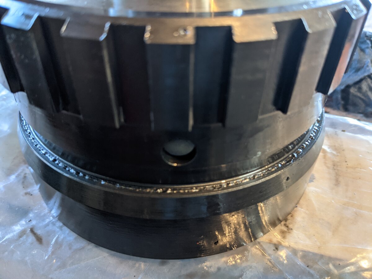

Moving on, I found some strange surface on the ring gear. I would assume this is just casting material that was not cleaned at the factory, but thought I would get a second opinion before I ignored it.
Looking back at where the barring seats on the planetary gearset you can see some maring of the bearing surface, but it is very minor. I honestly cant even feel it.
Overall what I think happened was when the transmission was last rebuilt (or more likely just had a few parts swapped, many of the seals are still old) the inner seal on the direct drive piston was not installed. This allowed ATF to blow by the inside and lead to low oil pressure, and thus low clutch pressure. That caused the material to start breaking down and overheat, leading the the destruction of the clutch. This dumped a fair bit of clutch material into the oil and that worked its way to some of the berrings tearing them up a touch.
Anyway, teardown and cleaning is basically done now. About ready to place my orders.
Im planning to get the following items
Center Support Bushing -- Bushing damage as photoed
Rear Planet Bushing -- Bushing damage as photoed
Anti Rattle Clip -- Was just flat out missing
Bushing Kit w/all bushings -- Grit from direct clutch messed up a lot of them
Direct Drum -- Was a mess as photoed above
Assembly Lube -- Can never have enugh lubes
Torque Converter -- Not internal, but still need one
I can also order a direct clutch piston if yall think I should
