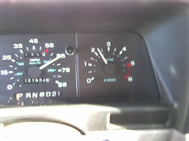

As far as what I'm showing for various RPM's...

i just have to say you got balls to take these pics...and how the hell are you in park?
Broken shift indicator cable. It's on my "to fix list" when I take the dash apart to replace some burned out lights.
And it wasn't hard to do - just sitting alone on the highway, shoved my phone up there, stabilized the speed, and took the picture.
How'd you get to 65 in PARK !!!:eek:
Just a thought to throw on the pile, when I had a U-joint replaced the stock was too small, had to use one from a full size truck. The mechanic said in the factory they have used full size truck parts if they were short on regular Explorer parts. Has the speedometer sensor been replaced before? Mine does the same thing and I'm considering picking one up out of a full size to see if I match the flow of traffic instead of blowing by everybody.
:) You should see what I can do in overdrive!! :)
As long as it's not a huge PITA, I'm going to fix the shifter cable (which I assume to be broken, a known 1st Gen problem) when I have the dash apart. Otherwise I'll just leave it as is and live with it.
