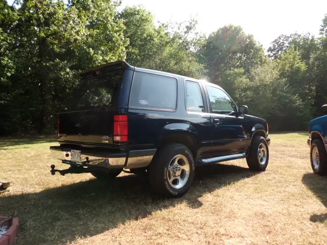

You can run Sport Trac 16" wheels on a 91-94, here's proof.

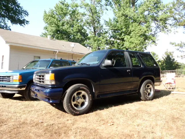

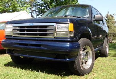

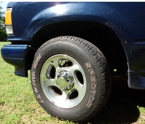

First image set: On my 2dr with 235/70R16 tires. Required 1.5" spacers. No clearance issues, improved road feel and stability slightly from my stock width 235/75R15 setup.

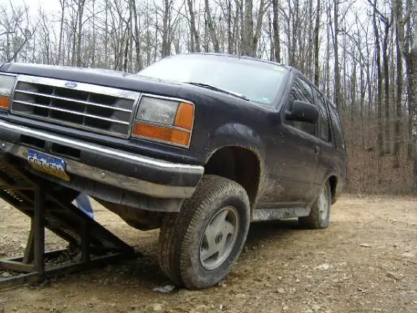

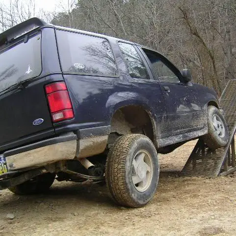

Second image set - same rims mounted on my 4dr. With 265/75R16 (31.6" diameter) tires and 1.5" spacers. Required a 2" lift to fit properly. Front rocker trim pieces (the small ones) needed slight trimming for clearance but as you can see it's not noticeable. Only rubs the inner fenders a tiny bit at full steering lock.

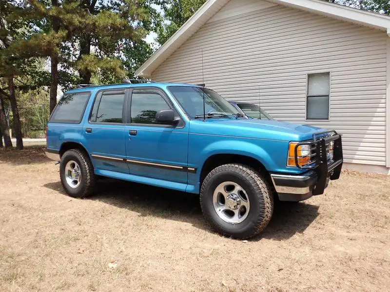

Looks great man, I think the XLT wheels would look even better. Definetly looks like they should've been on there from the factory.
These are the XLT's...
picture.php
yeah, spokes look better imho
