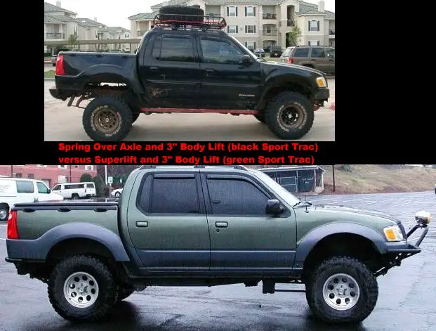

Comparison of a Superlift...
The black one on the top has huge shackles on it, it would be a lot lower with stock shackles on it. Just my 2 cents.
The black one on the top has huge shackles on it, that is what is giving it such a rake.
Pretty sure its the SOA thats giving it most of the "rake".
The bottom SportTrac is still SUA
what type of suspension lift is the 2wd sport trac using,im trying to find a lift for mine now and im coming up with nothing
If memory serves, the black 2wd Trac has a torsion twist and Ranger Edge 3.5" dropped spindles, a 3" body lift, add-a-leafs and rearched springs in the rear. It's also hiding a 350 Chevy engine, Turbo 400 tranny, and 5.13 gears, but that's a whole other story.
holy crap thats sick,but why drop spindles
