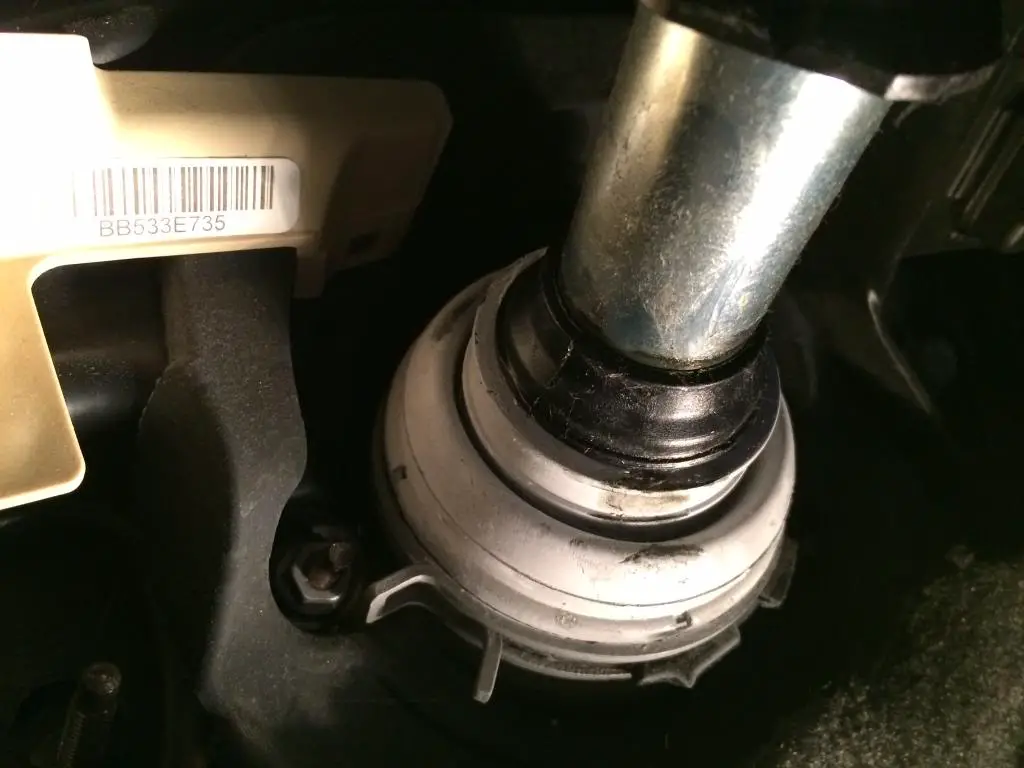

2011 XLT with 36k miles started making a moaning noise from the steering wheel area. Found a rubber boot at the base of the steering shaft that needed to be regreased.
Right above the brake pedal under the dash.^
Just push the black boot down grease around the shaft and slide boot back up, enjoy the silence.
