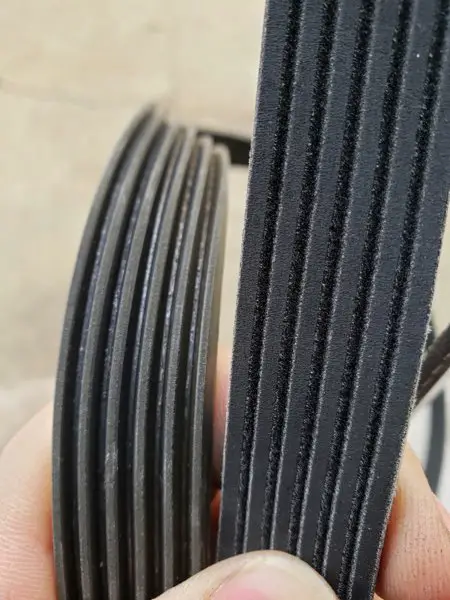

I entirely agree. If it works, case closed. I did buy the Napa branded belt today and it looks and feels differently from the Gates I put on previously. The last one I put on felt coarse; this one is a softer grippier (sp?) feeling rubber. The guy at the store basically confirmed it was a Gates rebranded belt, but it's a rebrand of the premium line. He also said save the receipt because the belt has a lifetime warranty!
Just installed it. The ribbing definitely looks different from the one I took out, too. The deep groove belt on the left is the one I just removed and the right is the Napa branded belt. Just for posterity and a matter of record I just turned 110,000 miles so if it goes prematurely I'll have a record here.

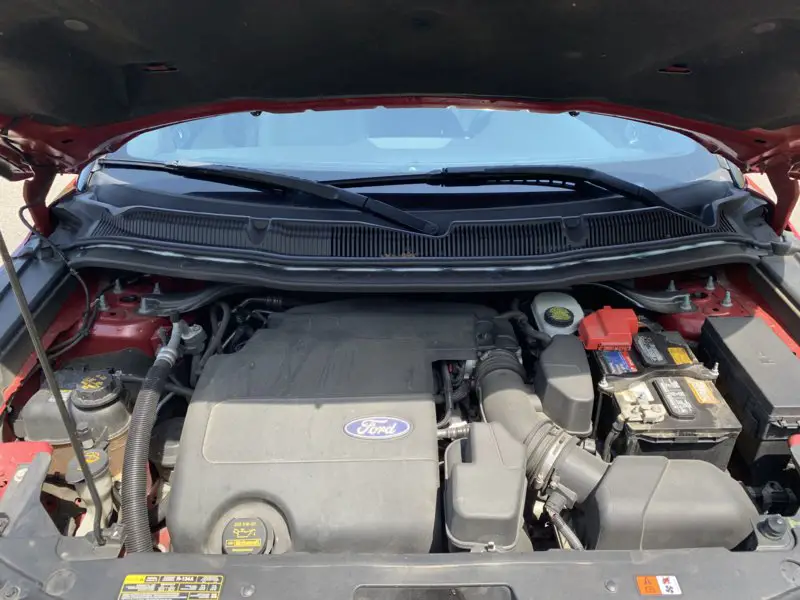

I’d like to bump this post. I have found the issue and fixed it. After spending close to $300 on parts it cost me $3.98 to fix it with a tube of exterior caulk. The seal at the back of the hood between the windshield and engine bay was leaking. I was washing the car for a trip and popped the hood to check oil. I could see a water trail straight down to the top of the belt. Why that seal is not glued down is beyond me. Anyways it’s held in place with connectors every 6 inches or so. Between them you can stick your entire finger under them. If the hood had enough downward pressure this may not matter. Mine did not. To fix it I applied a bead of clear caulking along the inside edge under the hood. I’ve drove for 3 months now. Thru multiple extremely heavy storms with not one belt squeal or power loss issue.

Thanks peter. Here’s a photo of the fix. Don’t mind the dirt we have been driving from Ohio to maine.
You can see the old water spot lines on the top of the engine cover. And my caulk job.

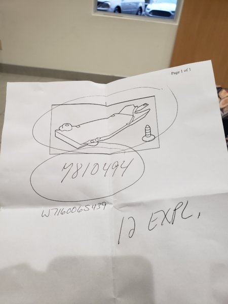

Hi Gang , new 2012 Explorer XLT owner here. This exact part fell off my “new used” explorer not 4 miles off the lot while I was driving . It came apart in two pieces and I saved the pieces.
The dealer’s mechanic was not there so no one knew where it went . It had just went through an oil change - does this piece need to be taken off to get at the oil filter?
Anyway does anyone have a cell phone picture , or a link to a video that shows this thing where it sits when affixed properly?
Thanks! Here is the link to the part I am going to order
https://parts.lakelandford.com/p/Fo...hield-Front--Lower/52427413/DB5Z9910494A.html
Update. This part is not to direct air. Only to prevent water from entering as southerngirl321 stated. I have included part number for the aformentioned lower shield (base part number 10494) specific number for my truck 7810494. Also requires clips to install onto frame. (Clip part number W716006S439).

And yes SteamboatTK the air director piece/shield indeed does cover up the oil filter perfectly. Must remove this piece to get to oil filter.
Thanks guys appreciate it. Dealer I bought the car from manned up, figured his oil change guy screwed up , sending me a $200 check. New air deflector is $83 delivered and the rest is for my trouble or some misc fasteners ...
