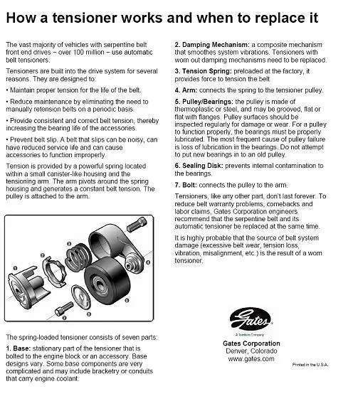

Tensioner insides
Found this on Rockauto.com. They are putting tech tips to parts.
Now I don't have to take my old one apart :D
