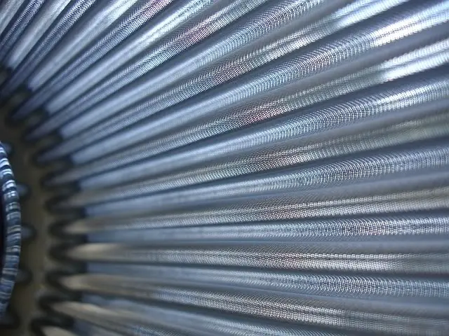

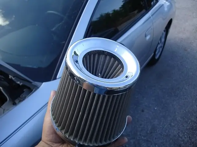

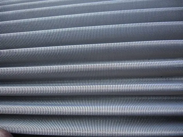

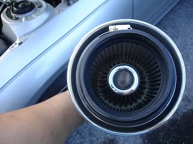

i use to have the ss filter, its mainly for show. doesnt do much for filtering but it damn sure flowed a hella lot better than any filter ive owned. that and because it flowed so well gave it a nice mean throatysound. i had it in my eclipse, and got rid of it when i got my ex.
heres a few pics of whatit looked like
that last picture is a dead giveawayof why it sucks at filtering crap out of the engine. and the cotton is just a joke for this filter, doesnt do crap either
