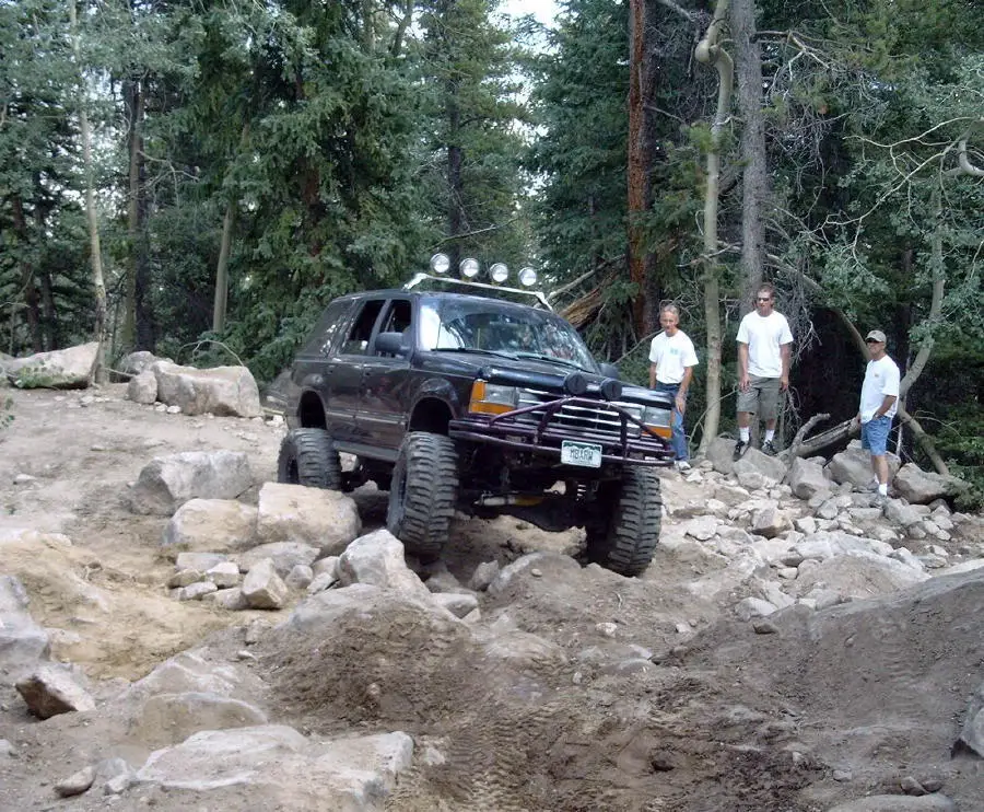

I run SuperLifts extended arms on my Explorer and have more flex out of it than my Ranger without extended RA's. Your gonna have it all apart so it would be easier to do at that time rather than pull it down and do it later. The extended arms do put more stress on the lift brackets(make sure you gusset them before install, I have a write up here on how to do it). Other than breaking the one bracket(lift bracket) I have never had any issues with mine. Heres a pic of mine. The front sway bar is still connected......
