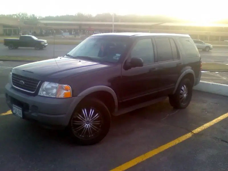

Im in the process of blacking out the explorer, started with the headlights. I know you can buy them off ebay but hell for the cost of tape and a little time I think they came out pretty good. What you guys think?
Before:
After:
Gonna just buy a set of blacked out corners, the right side is cracked anyways.

Looking good, is there a write up on the site about painting headlights like this? I am interested
I believe there is a thread showing some on how to do it but really its simple.
1. Remove headlight
2. Remove bulbs and clips(4) around the headlamp assembly holding the clear lens and the housing itself together.
3. Take a flathead screwdriver and lightly pry around the lens and the housing slowly to separate the two. (If you cant seem to get the two apart pop it in the oven at 300 for a few minutes to help soften the glue.)
4. Tape off any exposed areas you dont want painted.
5. Apply paint and let dry.
6. Apply a bead of silicone caulk around the entire headlamp assembly. (Make sure to do a good job on this, you want to avoid getting water and/or condensation in your freshly painted headlamp).
7. Firmly press the clear lens back on the housing.
8. Snap the clips back in place around the lamp.
9. Install your new headlamp and enjoy.
Hope that helps to those wondering the steps. Its really a simple process.

The lights look really good man. I have been thinking about painting mine and the weather is finally starting to warm up so I think I am finally going to do it. How long and at what temp did you bake them and what type of adhesive did you use to seal them back up?
I set mine on 300 for about 10-15 minutes after preheating of course. You might be able to get them apart simply by prying around the perimeter of the light with a flathead.
As for the adhesive, any silicone sealant will work, I used GE silicone scs1000 as thats what I had on hand.

I know this is useless without pics, but I painted my headlights yesturday and installed the JDM corners. There was no baking neccessary to remove the lens, I just lightly pryed around the peremiter with a small flat head screwdriver and the lens popped right off. They turned out great but the lens' are really faded and yellowed so I just ordered a 3m headlight restoration kit so hopefully that will fix them. I will try and get some pics tonight or tomorrow.

I'm doing this to my EB this week... The question is, High temp paint? Gloss or flat?
