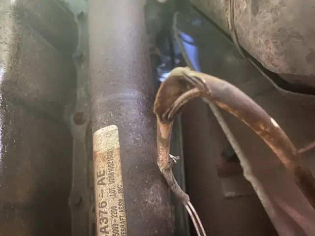

so far you’ve been 100% correct fuse 41 was blown. But when I try to crank the car it still will not crank so I’m suspecting it’s the neutral safety switch and I’m also going to check to see if anything is rubbing up against the front driveshaft. I do have lights on the dash but when I put the key in the start position the lights go out and I hear a relay clicking under the hood but the starter won’t crank I put a test light on the starter solenoid and had somebody crank the key and I get no power coming to the starter solenoid but if I put power directly to the starter from the battery it cranks but it won’t start obviously because of the blown fuse

Look what I found

well done! HEGO sensors are heated exhaust gas, they get lots of voltage at start up to pre heat.... those wires carry alot of power. If they get melted or caught up in drivelines, you will have some serious power issues until it fixed!
Way to find the problem! Visual inspection with a camera is always step one
I found the gray wire on The O2 sensor was completely cut through one of the white wires the insulation was worn out and also in the black wire. I tried putting a new neutral safety switch in place but I did not fix it. Will the gray wire on the O2 sensor being completely cut not allow the truck to crank?
