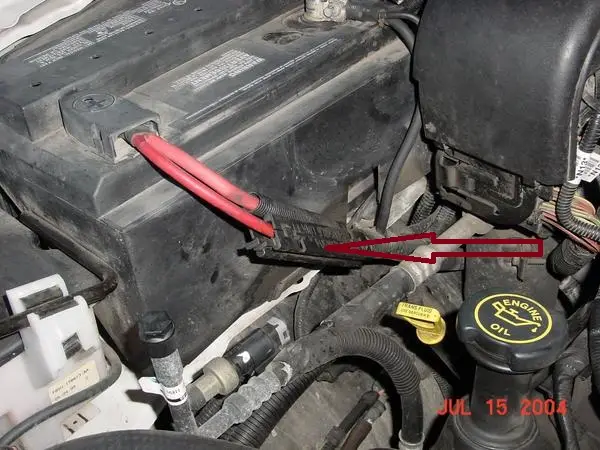

Sounds to me like you are not getting power to the power distribution block.
Fusible link.
You are looking for something similar to this in the wire running to the Power distribution block.
It is a inline fuse.
If it is bad and parts are hard to get where you are you can use one of an equivalent current capacity from any vehicle. Or you could bypass with any type fuse also with the equivalent current rating.
DO NOT JUST BYPASS IT. IF YOU HAVE A SHORT CIRCUIT SOMEWHERE YOU CAN CAUSE SEVERE DAMAGE OR FIRE!
