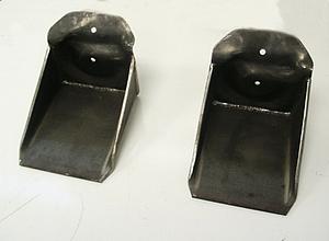

Speaking of which, are these buckets from broncograveyard good for the sas?
I plan to buy those buckets for my swap. Trckmagik used them on his FW swap he just finished and spaced them out 2" or so. Many other people use the coil buckets off the truck and those are the same things, but new. So yes they'd be good for the swap if you space them out. :)
Isn't there a bucket off some truck that didn't require you to space out? I forgot which one it was?
Yes, the 70-73 F100 2wd buckets were like that. I almost got some off, but then when I was going back for the last time(they were really close to being completely off), my parents said if I'd quit wasting my time trying to get those off (there are about 5 rivets plus 1 bolt per bucket :eek: ) they would pay the cost for new coil buckets and spacing them out, etc. :D
