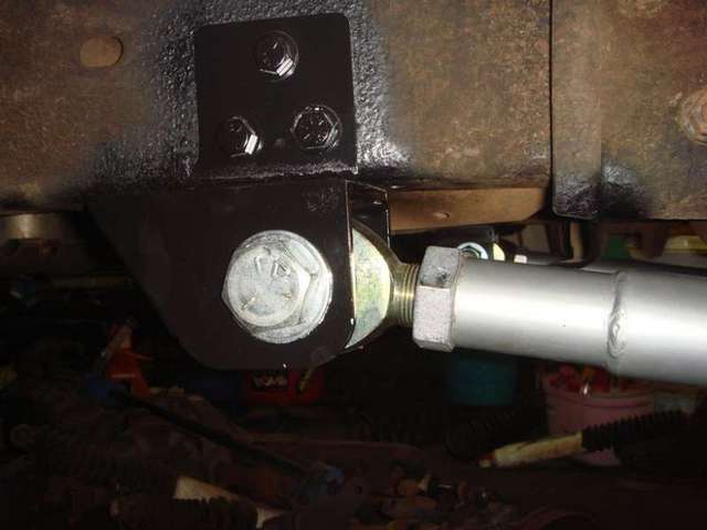

Did you have to space out the radius arm mounts from the frame or was it able to fit without a spacer. I'm kicking around getting the cage or duff radius arms and was wondering how you got them to fit and how you like yours. A pic of the mount would be great to. Thanks.

No, I didn't need to space them out. I was able to mount them straight onto the frame. However, due to the fact that the frame of the explorer does angle out a bit, I did have to modify the cage frame mounts. I'll post some pics of them when I can find them.

when you get a chance can I see a pic of your radius arm mount. I'm really thinking out going with the cage radius arms and just wanted to see how you mounted yours.
Here you go....
