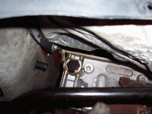

front or rear?
Can you tell if the rattle is coming from the upper right rear, upper left front or lower center front? The thread does not cover replacement of the right rear tensioner which is not much more difficult than replacing the right rear spark plug if you have the right combination of tools. The photo below shows what you see after removing the right wheel and inner fender flap.
The dark hex head is the outer end of the tensioner. If your rattle is coming from the rear I wouldn't wait till spring to replace the tensioner.
Some members have driven their SOHC for years with startup chain rattle and not had catastrophic failure. You probably will be OK waiting till spring for the 00M12 installation. Just keep monitoring the rattle for an increase in intensity.

Well I'm pretty sure its from the front (mainly hoping) but how would you reccomend diagnosing whether or not it is the front or back? I'm still kinda trying to even figure out where exactly they are both located

rattle locator
When my rattle first started before I could get out of the vehicle to listen it would stop. Eventually it lasted long enough that I tried to locate it with a mechanic's stethoscope. I had just as much luck using a length of hose. Mine sounded like it was coming from the front and rear. I couldn't tell if it was near the top or bottom of the engine. So far by removing the valve covers I have verified chain to metal post contact at the upper rear but not at the upper front. I suspect when I get the timing cover removed I'll find the jackshaft chain tensioner is shot.
