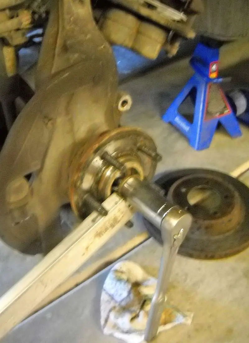

Here are some pics taken when I replaced my front bearing hub.
The aluminum bar keeps the hub from turning while loosening the nut.
The nut removed.

I'll share a trick I learned: the 3 bolts enter the hub from the back, and their heads interfere when wrench with the CV joint. In fact, the bolts have smaller than standard heads because of this. Most guys bust ball joint loose, pull knuckle away to gain access. Don't need to do that, turn wheels fully one way, get access for box-end wrench on one bolt, turn fully back the other way, get the other two. imp
