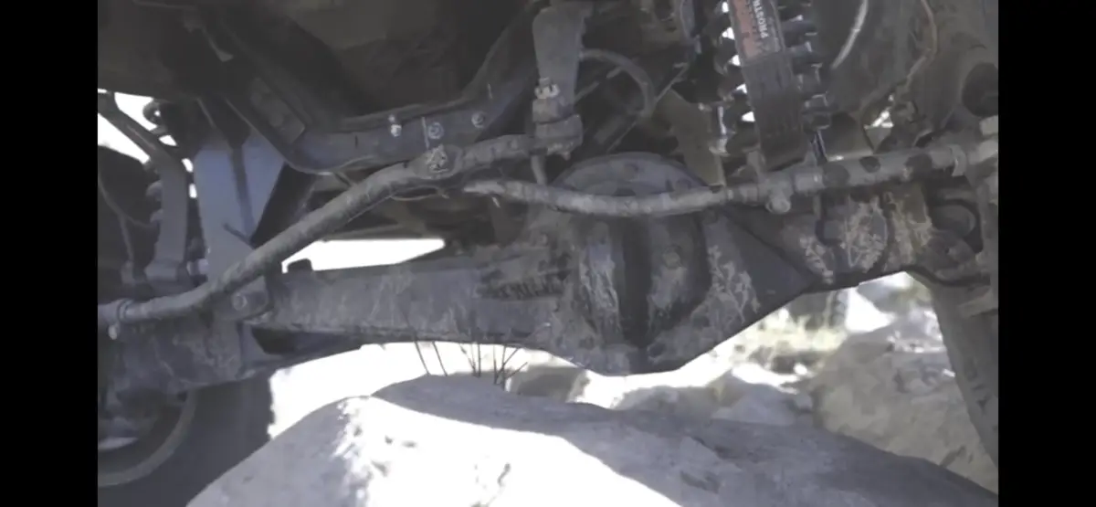

My tie rods need to be replaced. After seeing this I thought it might free up some down travel, be a little more beef than stock (bigger tie rods?) and clean up some bump steer. I imagine that the bend in the links would narrow the width enough to use in a stock D35 application. As you can see in the picture after bending the tie rod and drag link, they had to extend them, about three to four inches. Overall, trying something different. I remember years ago a small company (rock crusher steering, I think) tried a center mount equal length system but I don’t remember if it worked all that well. I don’t want to pay $2500 for swing set style steering and seems like a plausible idea for a cheap upgrade.
