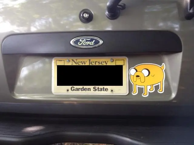

I did it to my trim pieces and just sanded them with one of those sponge looking sanders from lowes. After sanding i used acetone on them to clean them up. Also i would try to wash them before sanding to try to remove any dirt already on them.
Then i just used self etching primer and the spray on bedliner. It definately lost some of its texture after 6 months but still looks great compared to the ugly gray. Some people have recommended using an expensive UV protectant on it but i dont think its really worth it..
If i can figure out how ill show you some of the picture i took when i painted everything
edit:

I didn't use any type of adhesive just self etching primer so i didnt have to sand again after putting on the primer. I did do this during the summer though when the temps were around 80 degrees so not sure if that will yield better results for sticking to plastics.
I used this same method for the rear plastics, the front bumper plastics, the hood cowls, wiper blades, roof rack, and running boards
