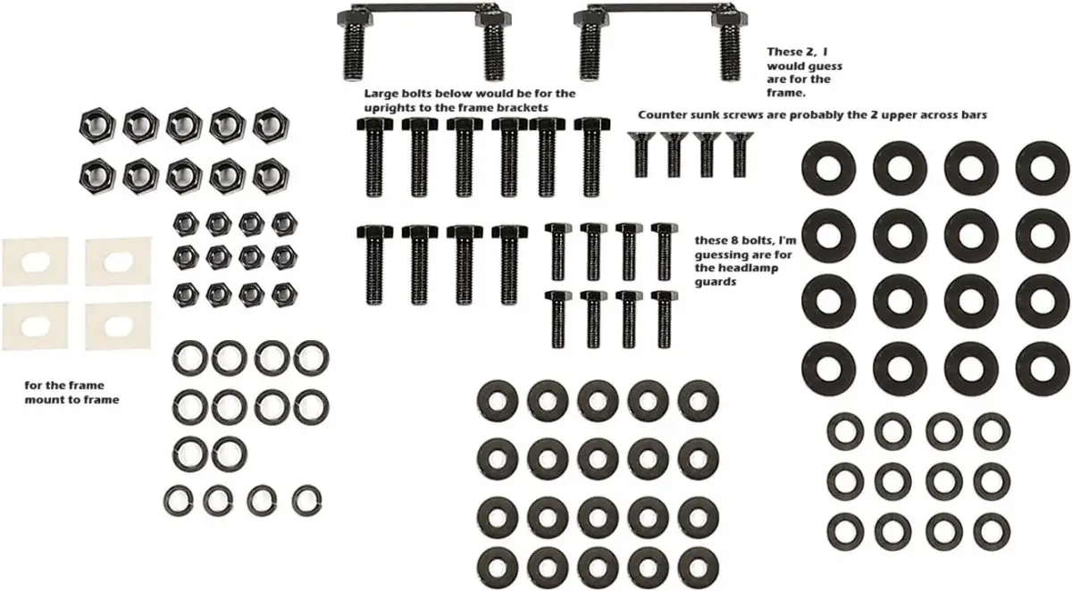

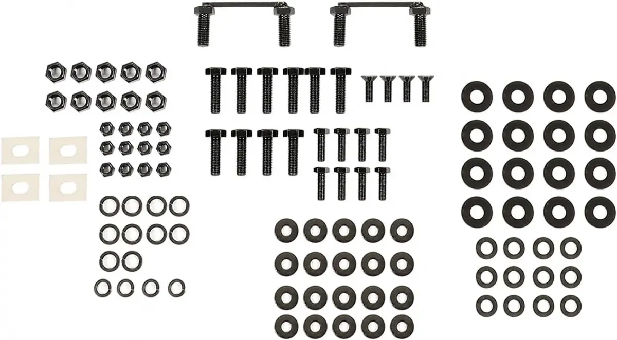

Count the bolts, nuts, and washers according to size.

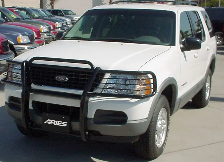

front view as you look at it on the truck

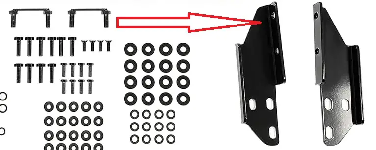

The above picture you can see how the frame brackets would mate up to the frame. I would guess it would bolt to the lower portion of the frame. Also, guess there are holes on the frame for them to bolt to, 2 on each side.

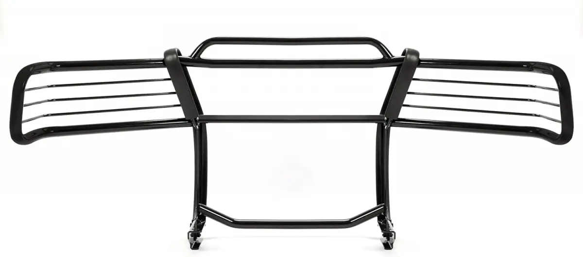

view as if you are the vehicle...

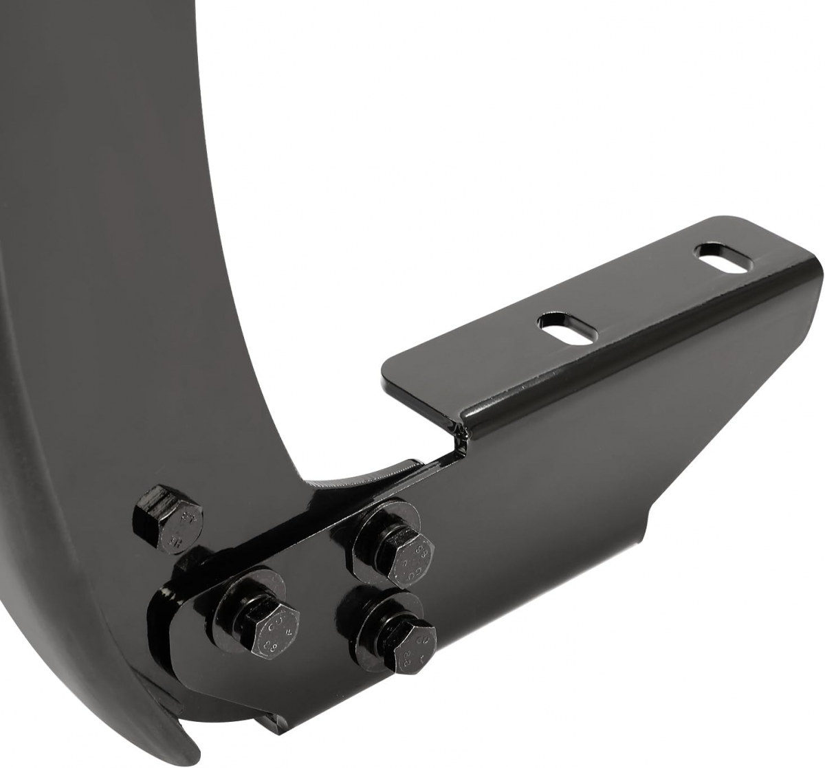

Below shows how the uprights bolt to the frame brackets.

Image is representative of Aries Grille Guard.<br/>Due to variations in monitor settings and differences in vehicle models, your specific part number (3052) may vary.
