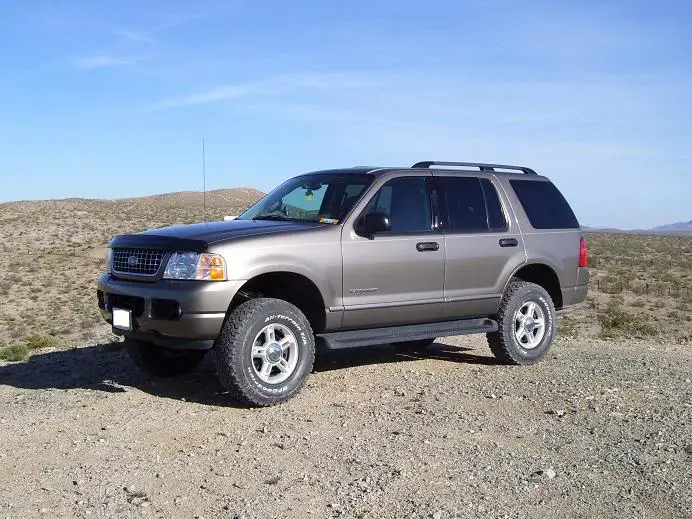

Hi, what size tires are on bamnq6's truck? And is there any body lift? or just your spacers? btw they look top notch Brandon and I think mine will make the list for spacers. I have the 3" body lift installed and new 265's on it now.
I don't know for sure, but judging from his signature, they are 265/75/R16 no bodylift.
Correct. 265/75/R16. They rub the wheel well plastics at full lock, but other than that they fit and look great. I've tried to ziptie treatment, but they still snag... So I'm just avoidin full lock, parking requires a bit more planing.
