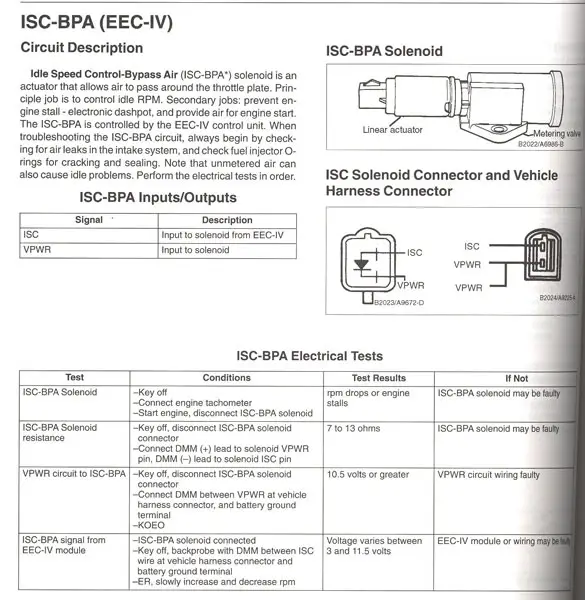

Taking a wild stab at it.....
I think that it is almost certain that the problem is with the IAC. I know you replaced it, but the symptoms are exactly what you would get if it were working intermittently. I think that it is possible that you have a bad connection somewhere in the circuit that controls the IAC. The clicking noise that you hear is when the power is applied to it and it starts working again. Problem is that the signal sent by the PCM should be continuously on.
I think you need to verify 3 things:
1) IAC is electrically ok
2) Wiring between IAC and PCM is ok
3) PCM is sending a continuous signal to IAC. The signal from the PCM is a Pulse Width Modulated signal, but you should see a varying voltage on a digital voltmeter.
IAC = ISC in the page below

Also, check to make sure that the inside of the throttle body isn't all gunked up.

I did the tests. I think I failed test number 3. I got zero volts with the engine running, ignition on but engine not running, and ignition and engine off. I made sure I had good connections on the probes so I am sure I failed this test. I guess this means that I've got a bad connection somewhere in the wiring. At least I know I don't need a new computer. Does anyone know where the VPWR wire goes from the Idle air control motor? Does it just go to the positive battery terminal? Where can I get a wiring diagram for a 92 Explorer?
