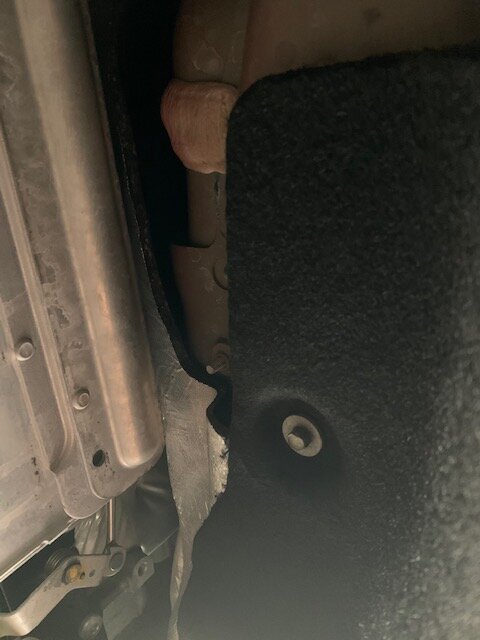

So I MAY have fixed my clicking issue. Once again it seems that an undercarriage cover is the culprit, except this time it is on the opposite side right under the driver's side dash. The connection has worked lose, and the metal(?!) washer rattles when the wind vibrates the undercarriage. I tried my best to tighten it down, but the bolt would not budge. In lieu in placed a stack of sticky felt spacers between the cover and the body to create tension and stop the rattle. Tested on a 20 min drive up to 80 mph and no noise. Fingers crossed. Will have to come up with something more permanent eventually though.
scottfmc, can provide a picture of the loose metal washer area and/or describe the location in more detail?

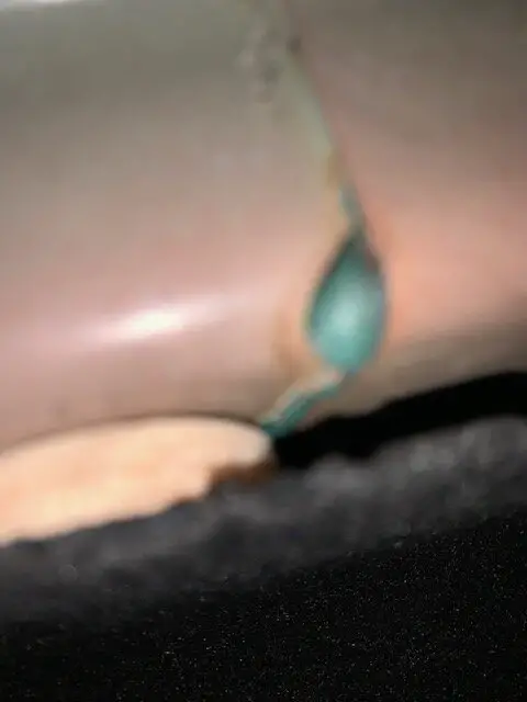

These pictures are not good, but it was the best I could get. The first shows the general area where the undercarriage cover is bolted to the body. This is just behind the front driver's side wheel. You can see the charcoal-covered felt-like material and the grey bolt that I could not tighten down any more. The washer behind it is the culprit. The second picture is blurry (sorry) as I could not get any better with my cell phone. The two felt sticky pads are the tan mass placed between the body and the undercarriage cover to immobilize the cover so that it would not move/rattle. The "fix" survived a 400 mile trip and rain. Since those are just furniture foot-pads, I will need to replace them at some point with something made of automotive rubber, but I no longer doubt the fix.
