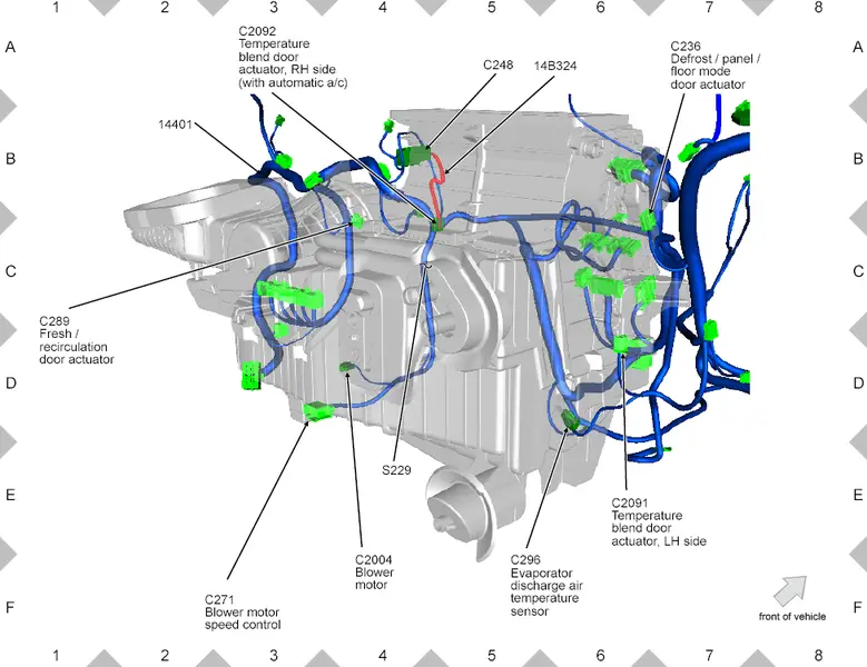

Hi everyone,
Have a problem with my front vents. I have read a bunch of posts, suggesting solutions, but didn't resolve mine. I have an issue where air (hot or cold) will blow from top windshield (defrost?) vents, and the small ones above the side vents, but not the main side and middle vents.
I have checked both actuators on passengers side, the one that is tucked in on the left of the glove box kicks in, and i get hot air if i need it, and the one straight behind the glove box also spins (i took it out) and i can see it working. I can also manually move the door in the vent box where air goes through and hear it doing the "clap" noise when it opens or closes for circulation. I ordered a new actuator, same thing, no change (figured because mine seems to work).
I still cant get the side and middle wents to blow any air out of them. I took the middle console completely out hoping i will find something around the vents, maybe another actuator on the driver side or something, but I cant locate anything. I have read in one of the posts that Explorers with Dual zone AC have one on drivers side. Is this true? Could this be the issue, and if so where is the damn thing located? Looking with my flashlight around i couldnt find anything that looks like an air box directing air.
Any input, or finger in right direction, would be much appreciated. TX got super hot, and my windshield is not what i need to cool down, my face is LOL
