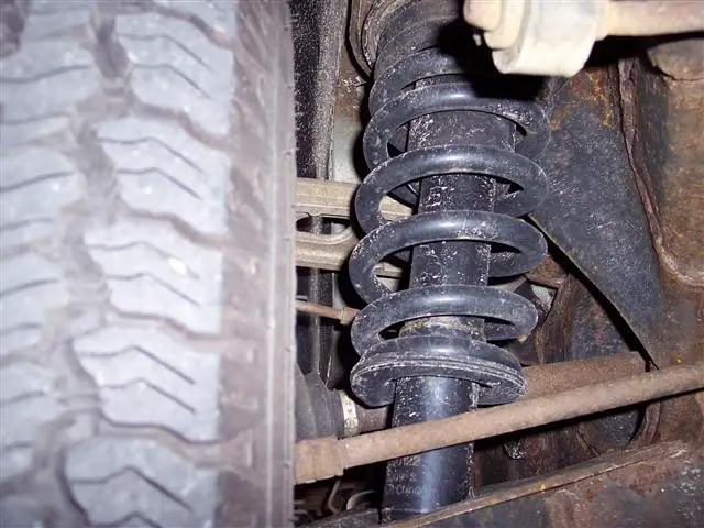

Left Rear:

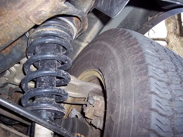

Right Rear:
I don't think are are longer. They are new, so they will seem longer. My Ex had both rear springs broken and had 150, x.. miles on it when these went in. That's why I gained 3" in the rear.

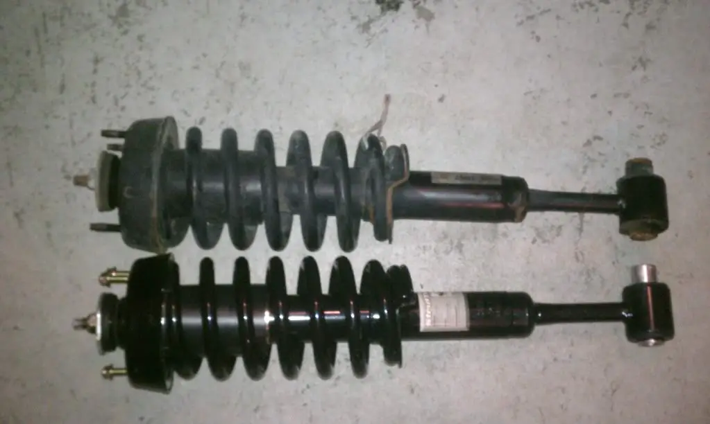

They do look pretty close in size. Is the stock setup fully extended(jacked up?) If so, you'll see that the top three coils are compressed as opposed to the new unit. Also, I just recieved two rear wheel bearing from the exact same company, sweet!!! Hopefully get my install done soon because I haven't driven my Ex in over 2 weeks:(
Nope she's sitting on the ground. I crawled my fat a$$ under there for the pics.

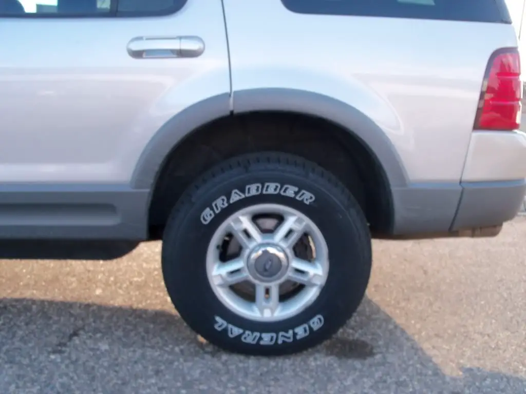

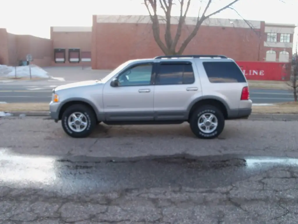

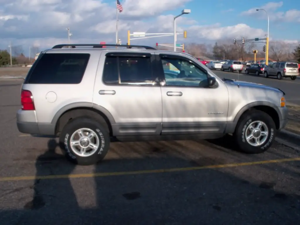

Here is some pics with the new tires. 265/70/16 General Grabber HTS. Truck rides very smooth now with these and the strutteks. Night and day difference from when I first got it, but it did have 112k with broken rear springs. I never imagined the bumps and rattles could ever be remedied this well. Feels like a new truck. Eventually I think I will put some lower riding strut assemblies on the rear to even the rake a bit. Probably Monroes.
strubby - F 33.8 in. R 36.4 in. I think you would need a 2in spacer to get it near even. Maybe 2.5.
I need a new camera, this thing is terrible.......
Looks much better with the 265s! About 2 inches, a spacer should take care of that. I'll have to call Brandon and see if he'll do just a front spacer. Only 67k on my X but I figure if I'm going to tear apart the suspension to lift it, new struts now wouldn't be a bad idea, not to mention to ride improvement. Thanks for the info!
