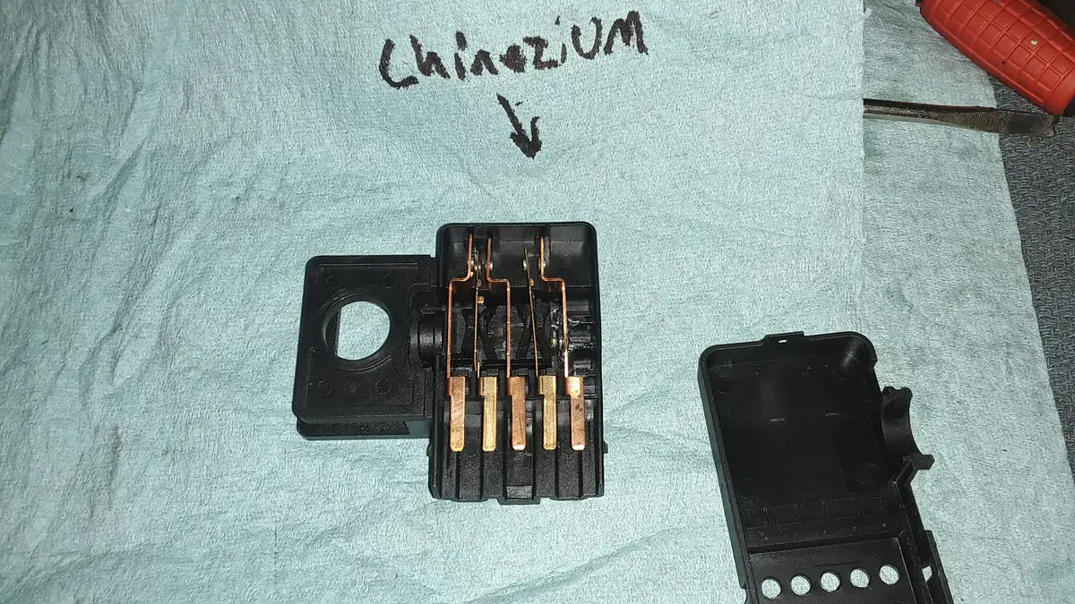

So after lots of testing wiring was fine
The solenoid tested good

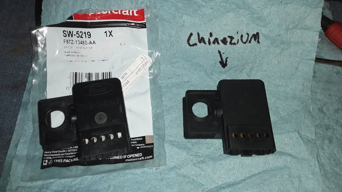

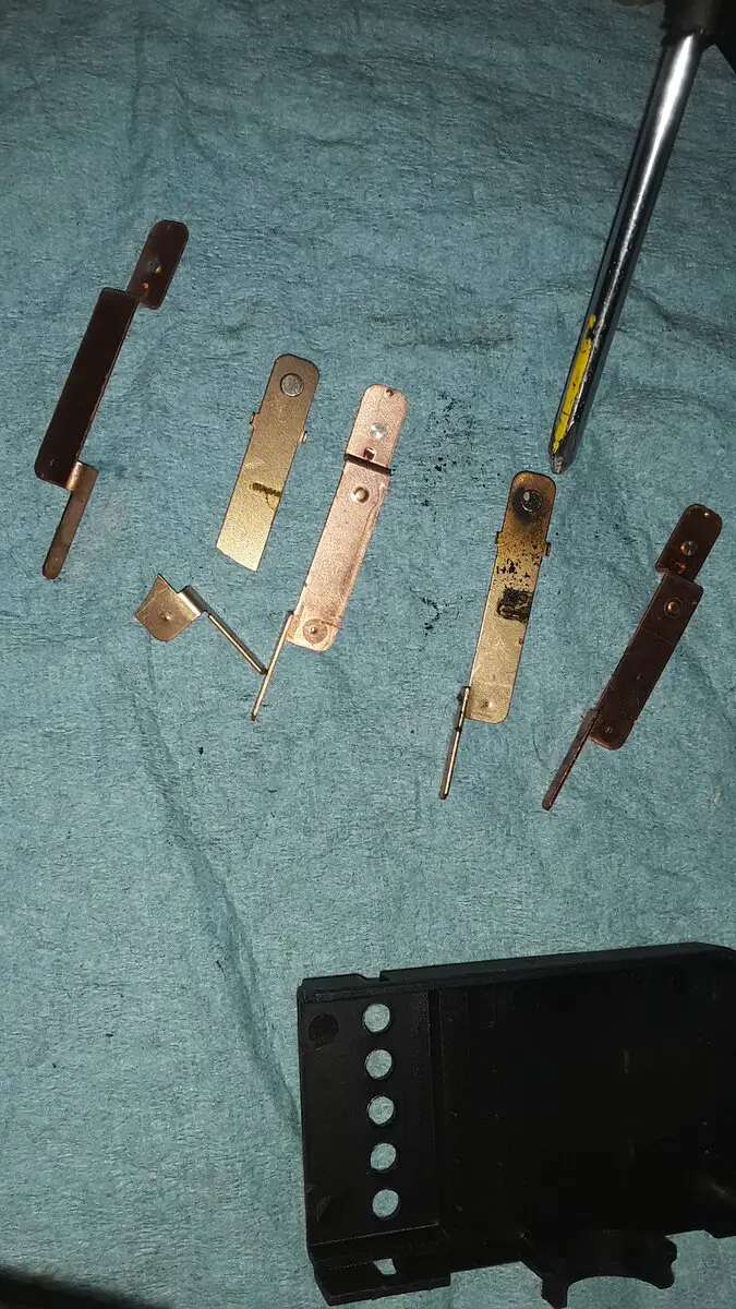

At some point someone installed a cheap switch and it took a crap
The burning of contacts might indicate excessive current flow above that for which it was designed. Then, too, the contacts are made as tiny as can be gotten away with. Contacts in heavy duty equipment like motor starters are made of pure silver.
Chinesium. That reminds me of the news lady saying the names of the 4 pilots on the plane that crash landed in San Francisco years ago.

Cool to see you fixed it and thanks for the great "tell all" pics.
This thread should be a sticky -
