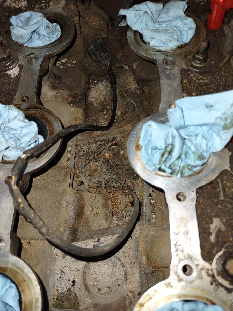

Does anyone know what this sensor is? It's in the valley between the heads, I just want to know since the wires are cracked and I'm going to replace them. Otherwise, I got the engine out and on the stand. Tomorrow I'm popping off the covers and pans, to to the timing chains. It was not as bad as I thought it would be to pull out.

Knock sensor

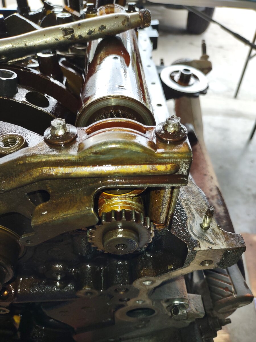

Big question now, is the balance shaft important. I rounded the two bolts for it's tensioner off (even with the external torx socket and hand ratchet). I'm not really sure how to get them out at this point. Can I weld a nut to them... Any suggestions?

Delete the balance shaft chain and tensioner not needed imo
