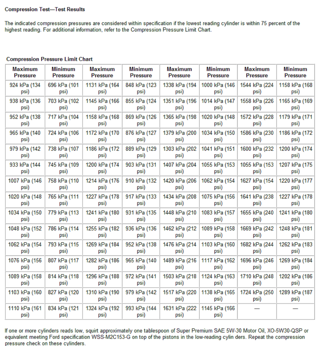

Hey guys, I decided to run a cold compression test (didn't feel like burning my hands) on the motor just to see what it was sitting at.
Cylinders
1: 174
2: 176.5
3:179.5
4:180
5:177
6:179
Is this good for the motor. It has 266468 on the clock.

All the numbers are close to the same
This is what I look for
Imo your numbers look good
Here is a chart from the FSM look in the last row

Those numbers are great, especially cold.
