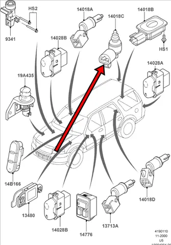

OK, I haven't done anything yet to fix this issue, but I have done some more research. According to www.fordpartsgiant.com the switch for the rear liftgate glass is the one pointed out by the red arrow.
14018C, Switch Assy - Alarm - Anti-Theft/Ajar, For Window Latch.
I have looked everywhere with the glass open and can't find anywhere that this switch might be. It seems that everyone is right about it being in the latch itself. Even the description states: For Window Latch
