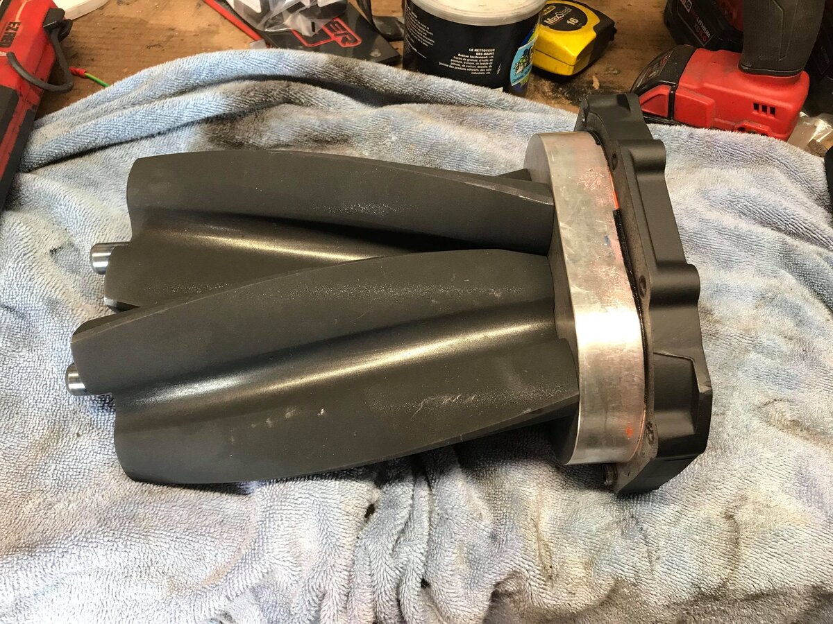

Crap. You are in uncharted territory for me on this one again too. I haven't even changed the oil in my blower yet because i fear having to take it off to drain it and refill it
Sorry to see this Tim. I'm hoping that it's something you can fix on your own. Just another procedure to learn.
i think i changed the oil in the m90 once. the m112 twice. i just wish i could figure out why it leaked out. i am sure it went into the case because there is no signs of oil on the outside anyplace at all.
it happens right? not really positive on me being able to fix it on my own however. i did call stiegemeier this morning and they said they will look for a rotor pack for me. i also called a few places here and nobody that i can find so far can repair them. i know winnipeg is a spec on the map, but sometimes i am baffled on how little support there is for things like this around me.
ive also posted in svt forum as well. not sure if i will get anything from it because i am barely on there, and most times people dont want to ship to canada. even when we are more then willing to pay shipping!
Just putting this out there
I been told several times by several people to only use anaerobic gasket maker ...oem...
Or the oil will leak out
My thoughts I'm probably wrong
The blower oil eats the rtv a piece came off ground to dust then a piece got into rotor pack seal s
Then all the oil leaks into your intake then burned.
And poof dolores was gone
Just my thoughts
i would agree on that, however i do have a argument for it. the m112 that i had was sealed up the same way, and never had a problem with it at all. when i sealed this one up, i used the right stuff. i literally was prying it on the tabs that you use to take them apart to get the snout and rotor pack off.
I guess the good news is that the oil blow-by you thought was coming from the motor, wasn't from the motor after-all.
The bad news is..........umm, we all already know the bad news. :-(
The seals that keep the oil in the rotor pack do fail and the vacuum in the intake will suck all the oil out through them.
If it had never been touched before it would have 11 year old seals? If it came off a 2009?
Get another rotor pack and install it, fill it with oil and then run it to warm it up. After it is warm open the fill plug and let the pressure out.
Then when it cools you will have a slight vacuum in the case which is supposed to help the seals last longer.
Check the oil frequently until you know it is not leaking.
Bob S might be able to install a clear sight glass fill plug in the snout for you in the future? I saw them on his site but am not sure if he has them for the snout you are using?
I had a M112 lightning supercharger start to get noisy and found it empty, swapped in another one and only used it for a short time.
Then changed to the M122 off the GT500.
Anyway, hope you get it back to life again soon! Truck is awesome!
That makes a ton of sense, that and I think it came off a 07, either way it never entered my mind before until that happened. Lol, bob was the first one I called this morning to. He is going to look and see if he has a core, will call him tomorrow and see if he found anything. I also called superchargers online, but they didn’t have anything in stock at the moment (was funny, they guy I was talking to I explained what I built but it sounded like a hack job, so I sent him the thread link, he couldn’t believe what the truck looked like or what the install looked like lol). i did however found a thread on how I guy took a m90 rotor pack apart and also gave the bearing and seal numbers. I have the link at home and will post it when I’m home from work. Now if they are the same and I will call bob and ask him, I have a local place that can get a lot of odd stuff like that. When I called them with the numbers I found in that thread, they had them in stock and probably will come out to $20 in parts. If that’s the case, I look at it like I have nothing to lose and may try to do it myself. Will have to make the gears, and rotors as well as check the measurements between the plate and rotors with a feeler gauge before taking it apart if I do it.

so i was able to find a rotor pack this week locally. this one too is a a brand new take off, so i am a little nervous on the seals being the same as the one that got trashed.

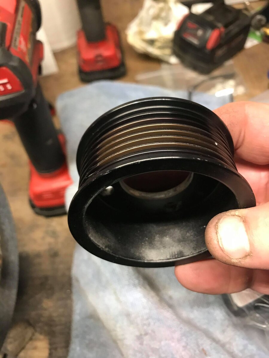

also took a look at the pulley that i had on the blower when it happened
i guess the motor didnt stall out as fast as i thought, or i heard it sizing up when it was happening.

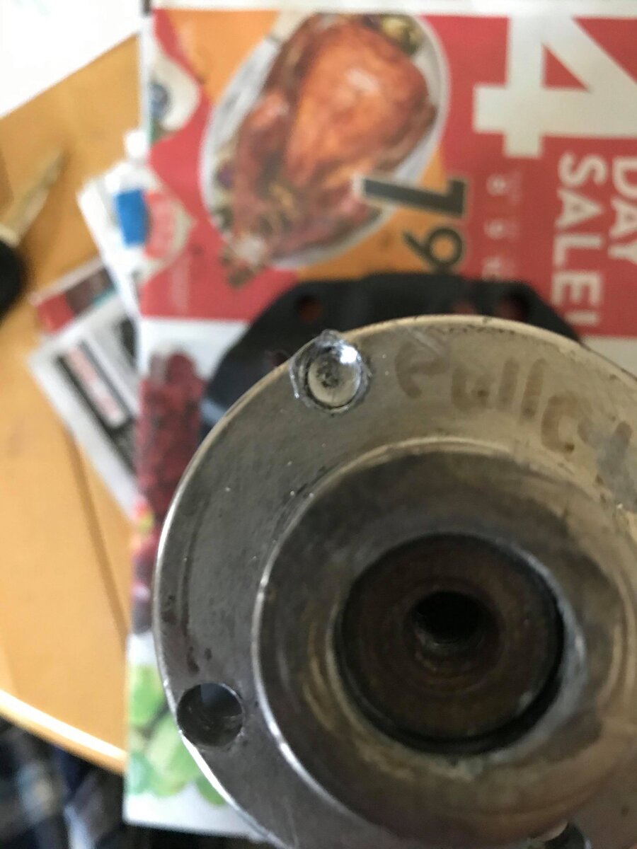

then it happened.......
wanted to make sure the bolts for the pulley were good and tight, so not thinking i used my 3/8 impact on it with the snout off and forgot i am using stainless bolts.....hub is buggered now. but this also leaves me with a dilemma on my hands. i can order a new hub from jegs for around 70 u.s. (90 canadian) before shipping. the problem is it wont ship unit the 19th and it will take a week to get here. there is a good chance it will start snowing by then.
or, i get a Billetflow pulley and hub from lethal performance that will cost 176 u.s. (230 canadian) before shipping. Billetflow Non-Slip Pulley System (Hub and 1 Pulley)
or see if a machine shop could make a new hub costing who knows.
the billetflow is a tad smaller, but grooved so the belt has a better grip, but will decrease belt life, and leave belt dust everywhere and they should have it in stock...i think.
get another metco hub, and hope this doesnt happen again, and just wait for it to come.
or machine shop, and take my chances on price and if it will last......
on a side note, the pack i got had a grey finish on it, not black so i ended up having 3 different colors on the blower. once again i knew that would only last so long with me, so i figured i would paint it and the snout so they all sorta match a lot better.

that hub cant be saved? What is the material? steel?
Dang stainless bolts so soft!!!
