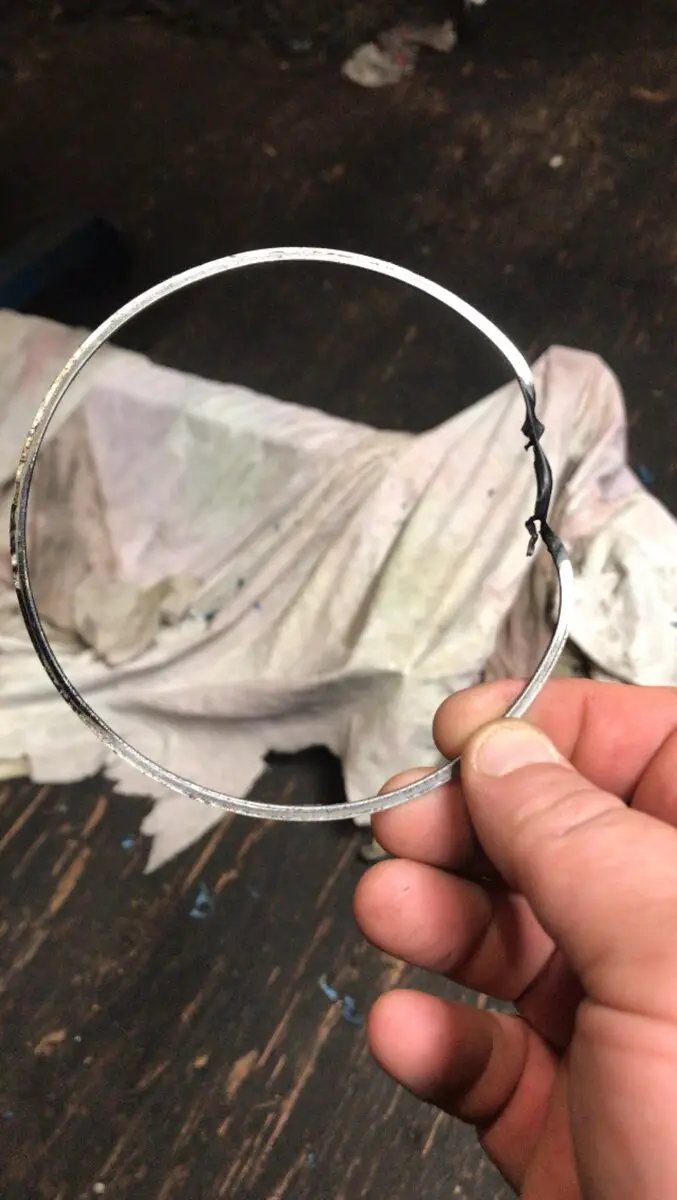

so.....where to begin....
well, where i work, sometimes you see stuff brought in that really breaks your heart.
earlier this week this was brought in

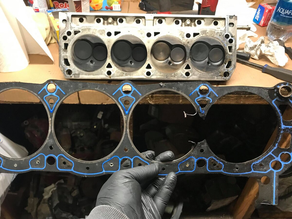

relax, this isnt don's old truck. as a matter of fact, this is one of my old trucks. that i owned twice. long story as short as i can make it, i bought it 4 years ago, fixed it up, and sold it to a little lady. then last summer i bought it back. this was one of the very rare trucks up here. a 2000 limited with a v8. she had to park it shortly after i sold it to her, and she parked it at a friends IN A BUSH! but it ran like a top. bought it, drove it home, then re sold it to a kid that was going to fix it up. guess he didnt fix it up because it came into work on monday. i literally spotted it from 300 feet away. i know it was one of the trucks i sold because my kid fed it to a snowbank, crumpling the front fender, and the heated seat button on the passengers side was broken. all the v8 stuff was gone. i was able to pull the mirrors off (has heated puddle lamps) alpine front speakers (which i didnt know it had) and the rear diff for a former co worker that wanted it because it was a "holly grail" 3.73 track lock that he will be putting into his 53 f150. after that was done (and the entire time i was apologizing to the truck as well, weird i know) then it was fed to the shredder. still hate myself for that to.

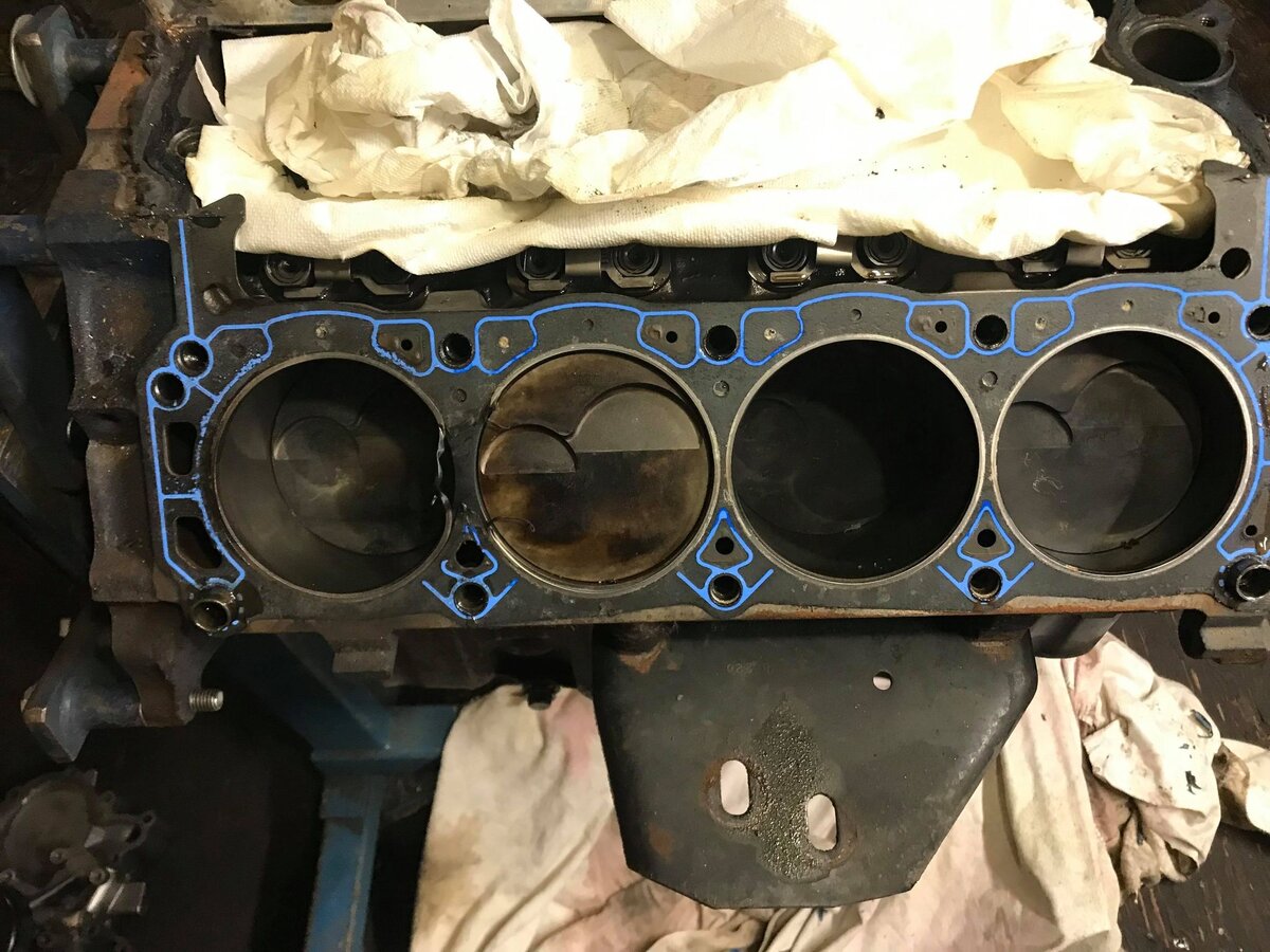

moving on to tonight (or last night depending on when you read this) it was time to perform the autopsy on evils old 347, and all i will say is....wow.....
i knew the head gasket was blown between 3 and 4, but....well, you look
if your going to screw something up, make it worth your while, BUT WAIT! theres more!!!!!
thats bank 2! it wasnt to far behind! glad i'm going to MLS's now! oh but wait! THERES EVEN MORE!
can you spot the problem? if not, i will give you another clue.
in my hand it the locating dowel for the cam sprocket. the other part of it is still in the cam! i have no idea how long it was like this, or even how it happen, but once again, it was a train wreak waiting to happen!
the motor is apart with the exception of the cam and lifters. i will pull them tomorrow. i wanted to get the crank out so i can get it all rebalanced. all the bearing looked good with one little exception.
these are king crank bearings. im not sure if i should worry about the scuffing on the trust bearing or not because stupid me didnt check the end play before i tore into the motor.

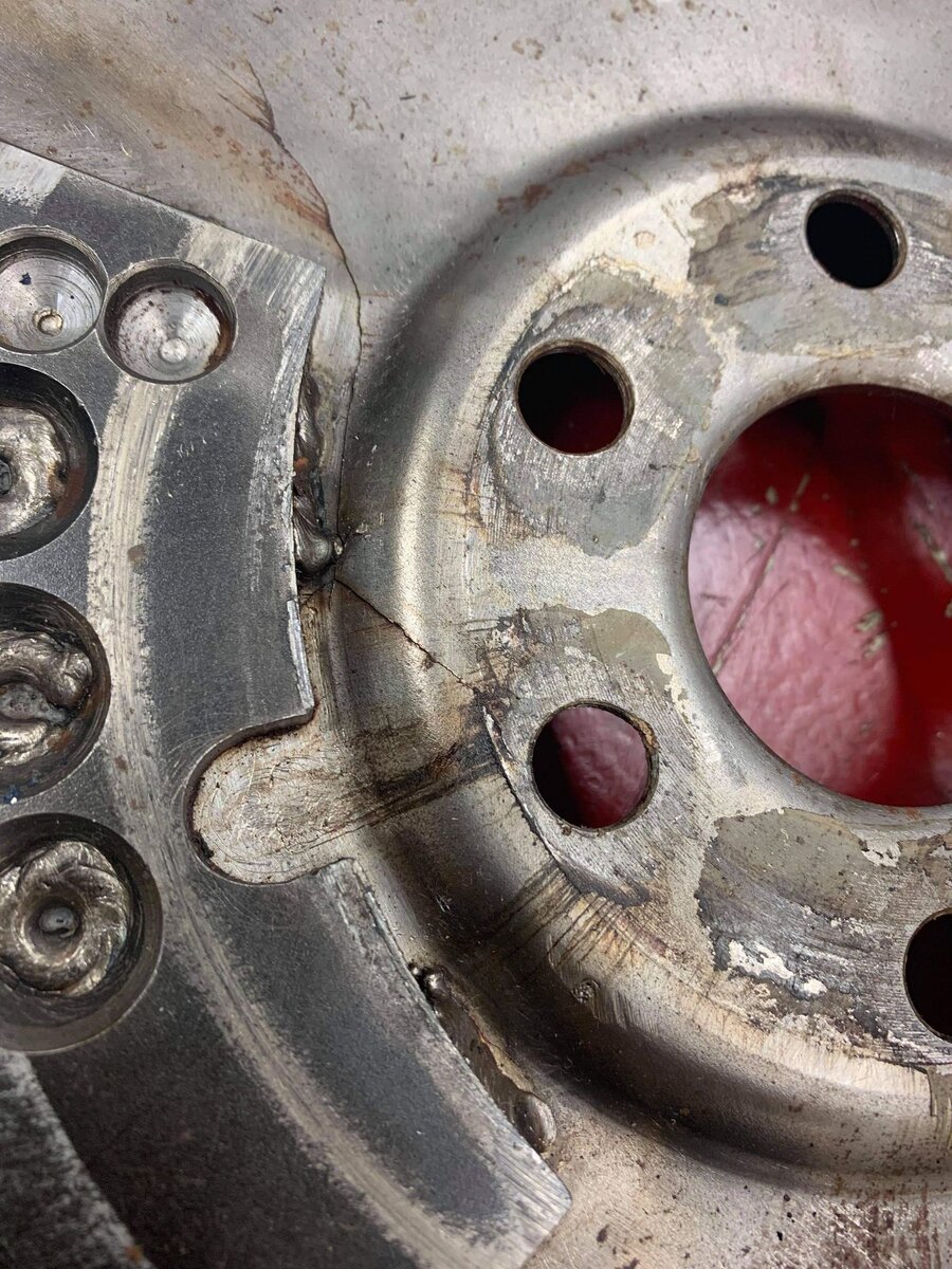

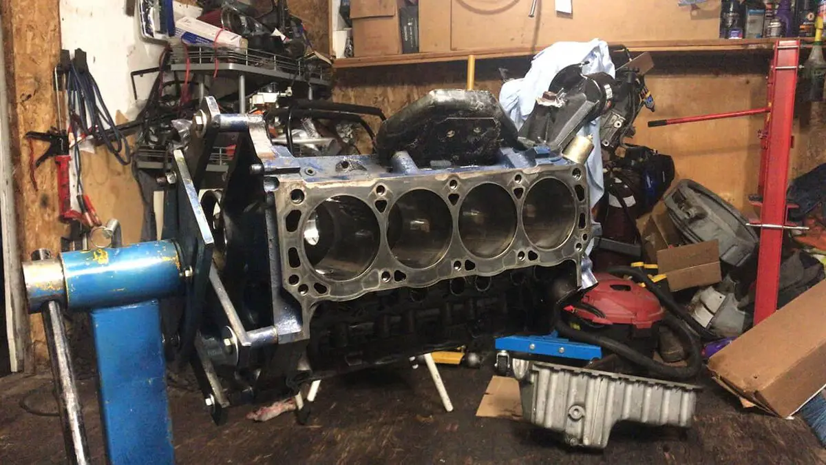

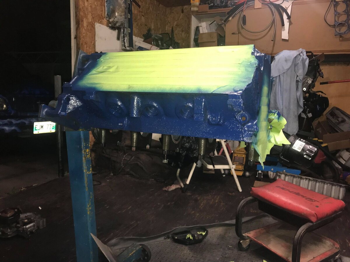

dropped off the crank, balancer, and all the stuff that you would need to have everything balanced to the machinist thurs. evening. he was pretty impressed on how well the bearings as well the rings looked. even the crank showed zero wear. however, he did say because of the damage to the front of the cam, i should replace it, as well as the timing set. sucks to because he had mentioned the lobes on the cam looked very good as well...
so on i went on my block clean up
then tonight i get a message.....
"you do know your flexplate is cracked, right?"
um....nooooo.....
that totally got by me. glad he spotted it, because that to would have caused all sort of bad things. and me having no feet!
what started as a blown head gasket sure has snowballed. im starting to think, this is my spare motor at the moment, why am i dumping money into it?
once again i am living up to my screen name, not that i am proud of it.
