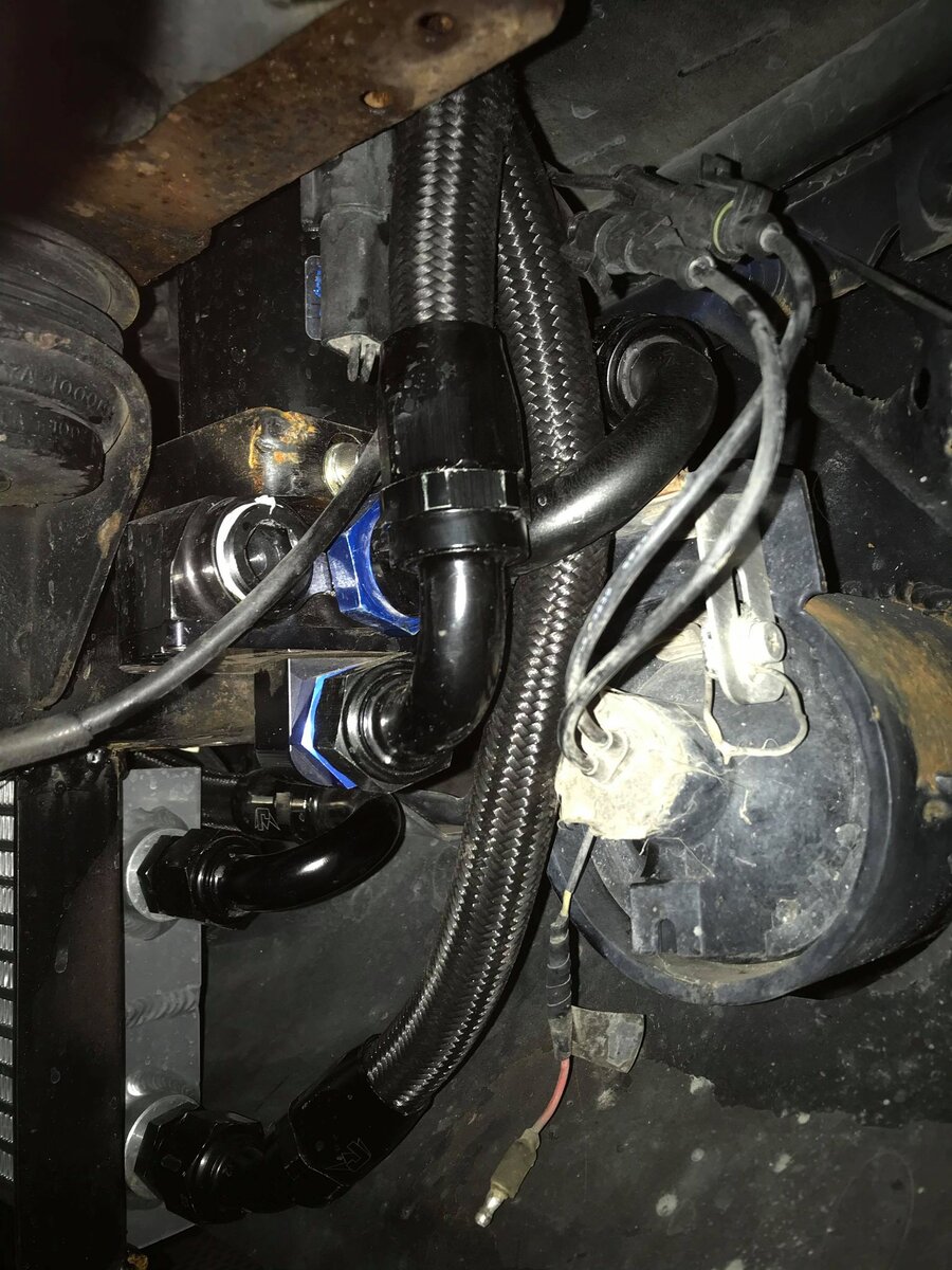

this makes me scratch my head. any ideas anyone?
The temperature sensor is reading the exhaust temperature of the blower the act of compressing air creates high temps it doesn't matter what temperature the engine block is when 200 plus ° are coming out of the blower
I hope that explains it
I was having the same temperature problems as you until I got the methanol location worked out Now it never goes above 140 on the highest end Normally about 118 under boost with the meth kicking
I Am super Glad you are driving it and she Is running and working well!
i totally get your explanation, and yes the sensor is under the blower.....kinda. the innercooler is below the blower, then then the sensor. thats what i dont get (unless i missed something you explained). it should be reading the temperate after the innercooler.

have a friend here that did a terminator x i will say 5 or more years back in a ranger. when he saw it last night he was baffled that i no longer had the ford ecm in it because he thought you needed it, and still ran his. he is now going to rip his out so he can clean up his wiring as well.

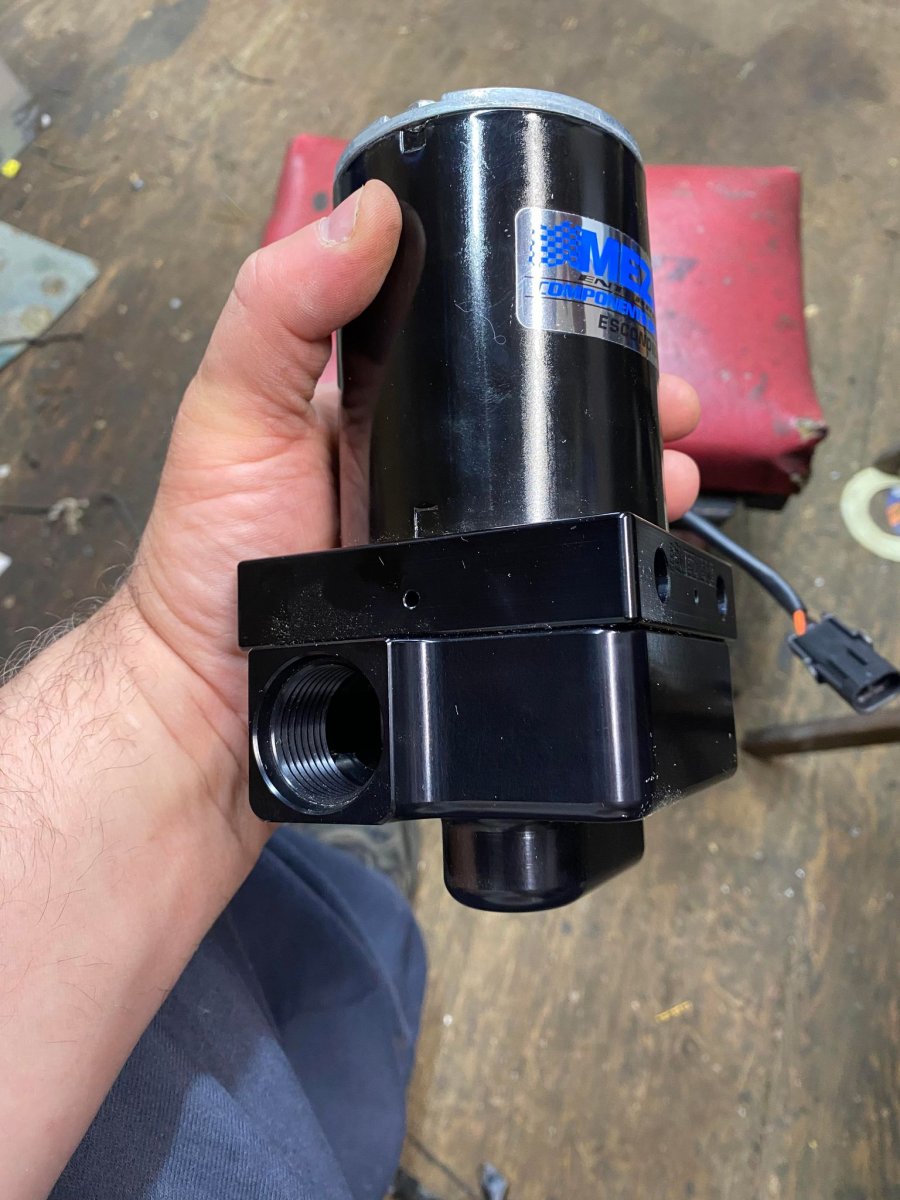

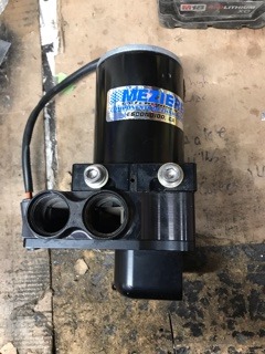

Sounds like the inner cooler pump isn't pumping fast enough to move the fluid around
Maybe time for a fan
lucky for me i have a new spare! wish i could find out how many gmps it is or isnt pumping.

when your old pump died on you don, what did it do. just stop working, or you knew it was time to get it rebuilt. i might try swapping in the new pump i have and see what it does.
after a wot, around 150ish i believe. i couldnt see what they were before with the old m112, or when i first put the m122 on. you would actually know better then me lol.
pump, maybe. it was used after all and i dont remember how many hours were on it. not sure if its weak or not.
150 at the end of a wot run isn't bad at all. Lower is obviously better.
When my pump failed, it became very noisy. It was also for me to open a cap and visually see the flow.

well the pump i have now was noisy right from day one. i know if i open the cap for the innercooler, it will spray all over the place.

Maybe you can have a listen to my pump at some point (I think we have the same pump WP136 ?) Electric Pump Remote, 20 GPM Inline, Single in-single out
thats what the new one is. not sure how busy you are on fathers day, maybe ill drop by when i go to the parental units.
i did however run into a problem with the pumps, because nothing comes easy.
new pump.
pump thats in the truck.
the inlet and outlet are in different spots. :banghead:looks like i will have to either get creative with my hoses, or outright redo them which i really dont want to do.
