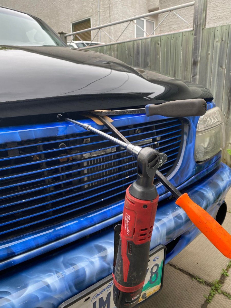

if it isnt one thing or another. anyone have a link to a thread showing you how to open the hood with no cable?
today called flex a lite and explained my temperature probe problem. long story short, the first twit hung up on me when i asked to speak with a supervisor (yea, karen move, i know). i called back, this time the person i talked to was more human. she is sending a complete controller kit out to me, no charge. with the exception of the first person, in the past i have always had great customer service with that company.
thanks don, but i found another way....
everyone in those threads have or had stock grills. my saving grace was i dont have that filler panel between the grill and the rad support.
also slowly your black truck is being put back on the road one part at a time lol. when i got the hood open the cable was not broken at the latch, or the handle. must have stretched over time from me opening it a bazillion times.

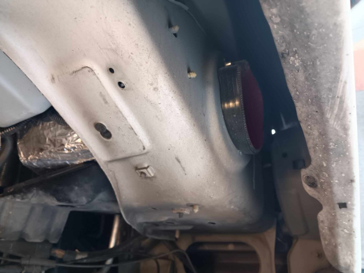

I saw the picture you posted of your air filter in your engine compartment and see you don't have a cold air intake setup.
This is one reason your air intake temps are high.
Maybe you can move the air filter closer to the fender by extending the tube and then cut a hole in the fender to allow fresh air in.
I made a somewhat functional cold air set up by cutting up a plastic container and the inner fender area where my battery used to be.
i have no argument with you on this one. i was hoping that because it not being near the rad, and off to the side i would be ok. i am going to have to do a pile of relocation if i want to do it on the drivers side. fuel pressure regulator, HID, fan controller, and puke box all live on that side. doesnt mean its not do able, just means a whole lotta figuring out.
i am guessing that comes out of the air box? i wanted to do something like that, but couldnt figure out how to get a air filter in-between the fender and fender apron.

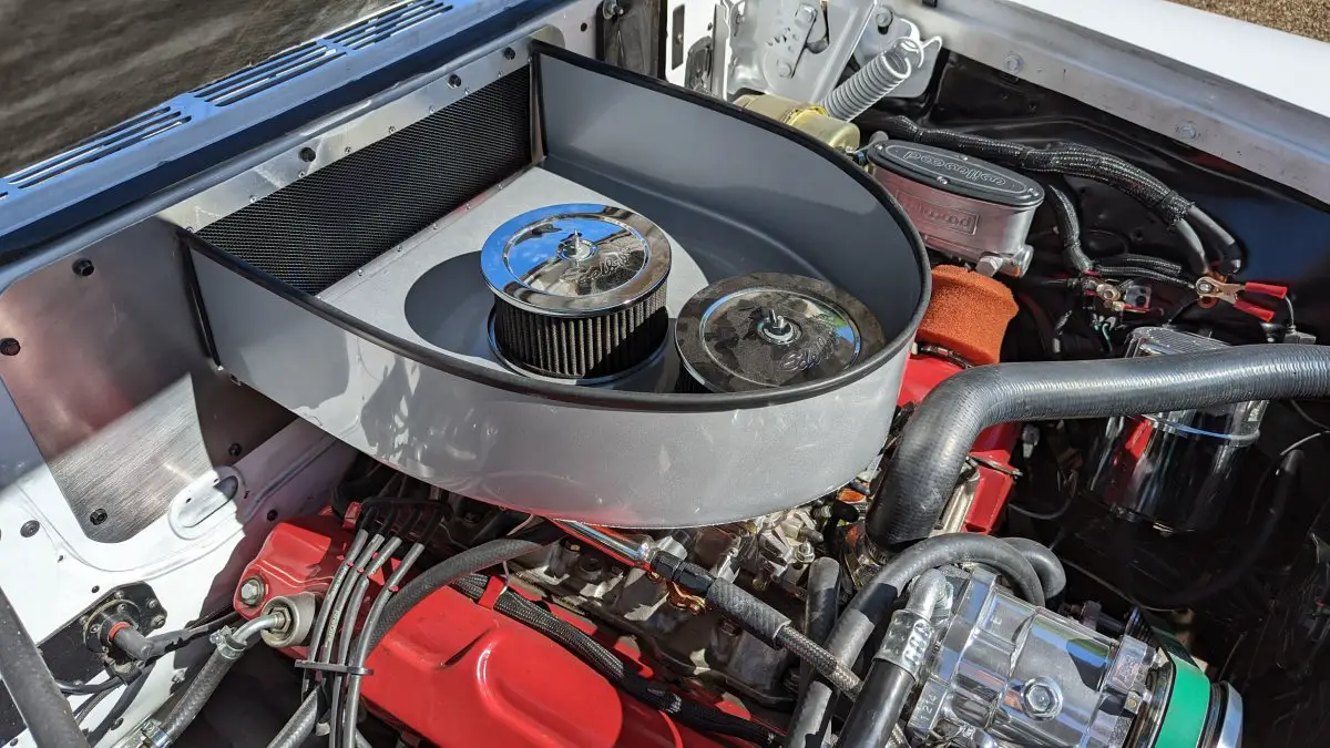

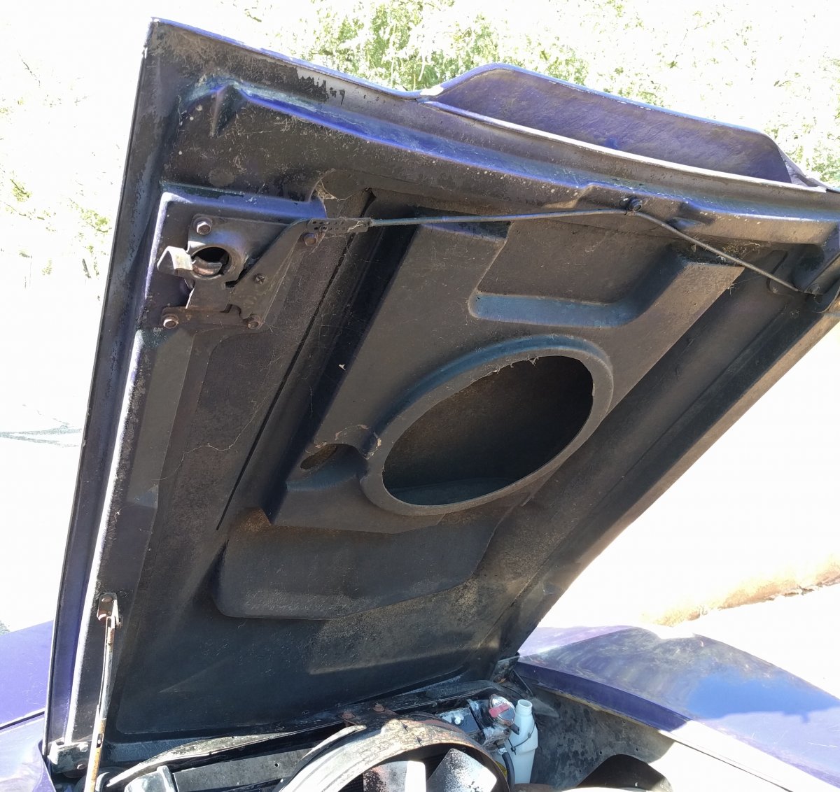

There is a high pressure area at the base of the windshield where the oncoming air is being slowed by the windsheild that is how the L88s hoods work as intakes on the Chebys.
I used the cowl vent on my 1960 Dodge in the same manner that NASCARs did to feed cold air to the carbs. This air pan seals to the insulation under the hood and only pulls air from the cowl. It made a huge difference with hot weather drivability.
L88 Corvette hood

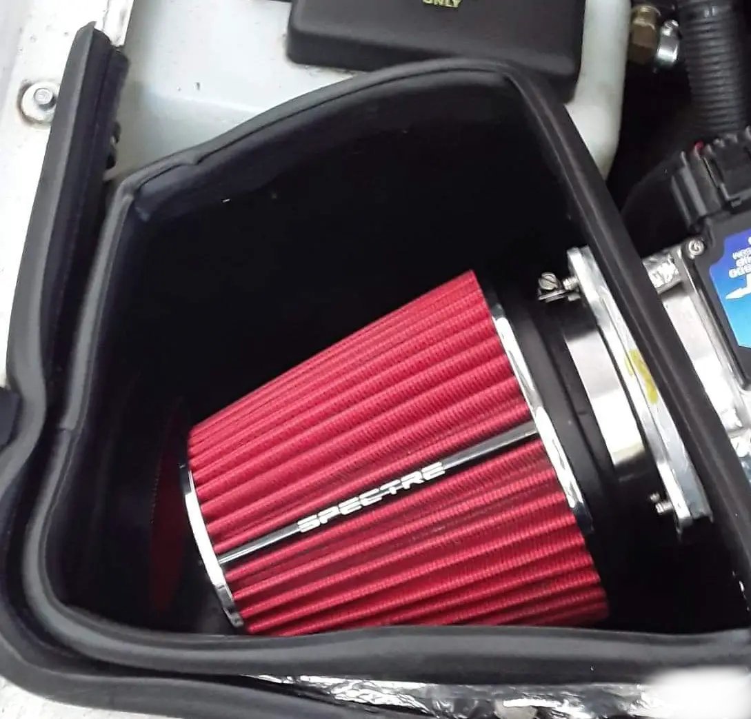

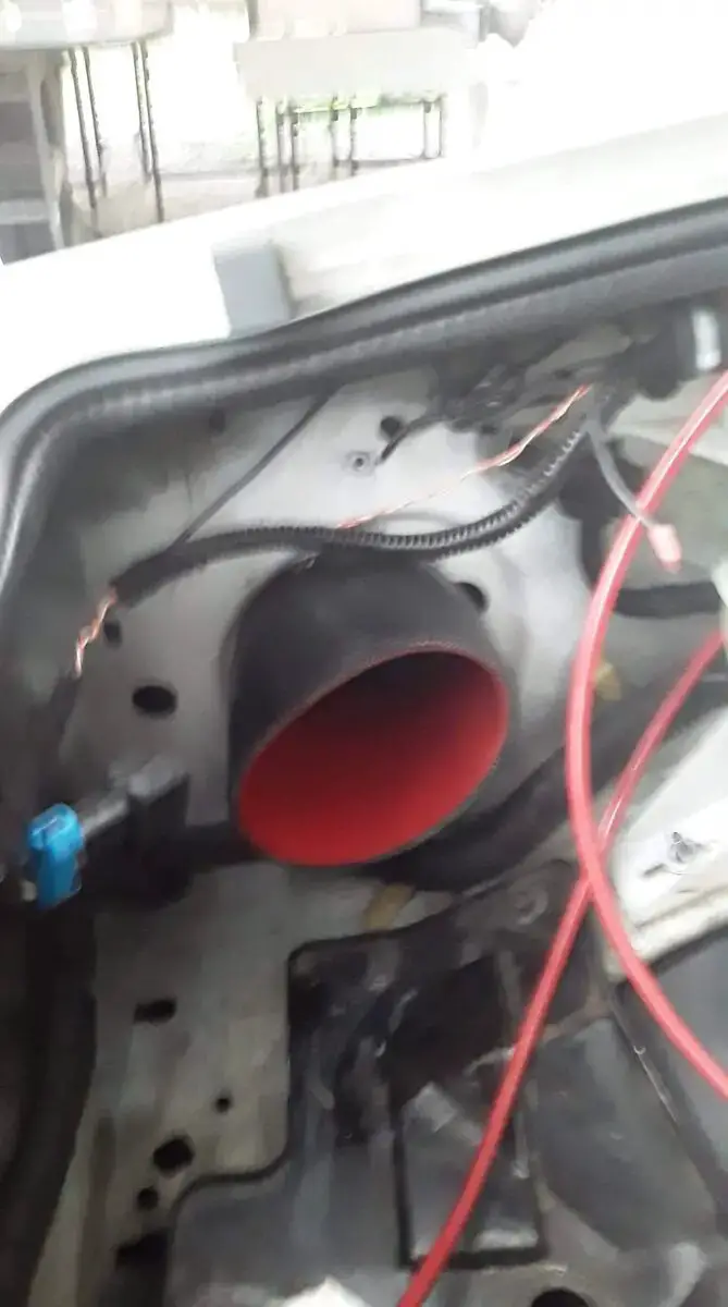

Pictures
Yep It goes right through the hole in the fender Apron
Then it goes into the air box
So when The hood is closed Only air from inside the fender Is used
Dropped my intake temperature significantly and my air filters take twice as long to get dirty
L88 Corvette hood
Pictures
well then. looks like with this info i am going to be trying to build some type of air box. it also looks like i just spent a ton of money on a hood i dont need........
