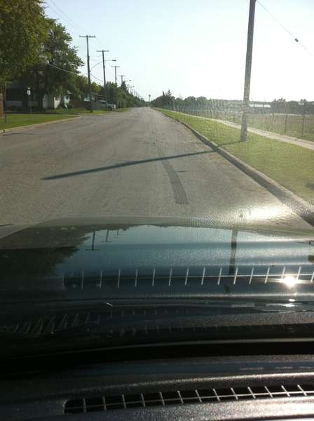

and the end result :D
what you cant see is the 3 foot patch when it hit second. i need a posi, i know....

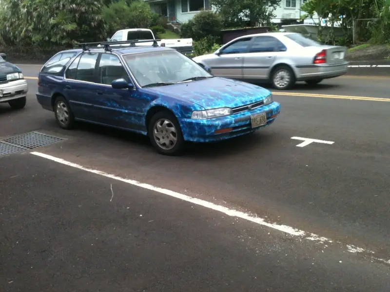

Tim's is definitely the better looking of the twins.
Pretty amazing. I guess its true, we all do have a twin out there.

so today i was bored (like i kinda am now) and figured i should go on a test flight to see if there would still be a vibration at speeds with the new drive shaft. 100 km (62mph) nothing. 110 kms (68mph) tiny bit. 120 kms (74mph) evils giving me a message. 130 kms (80 mph) i thought any and all teeth where going to rattle out. back to the drawing board.
