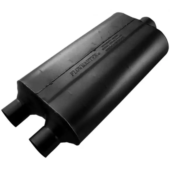

I swear this flowmaster muffler sounds better after a few hundred miles
Could be. Some have packing in the mufflers that burn out after a few miles and they get louder and the exhaust note changes.
My dog has a better guess. If it is a chamber muffler there is no packing. A turbo style does have packing and will break-in.
I wonder also if you have blown the cat(s) out as it is now tuned well and your likely getting on it.
Some mufflers have had packing in them that burns out after some use for decades. You must have an ivy league educated dog. Why does my comment trigger you so much?

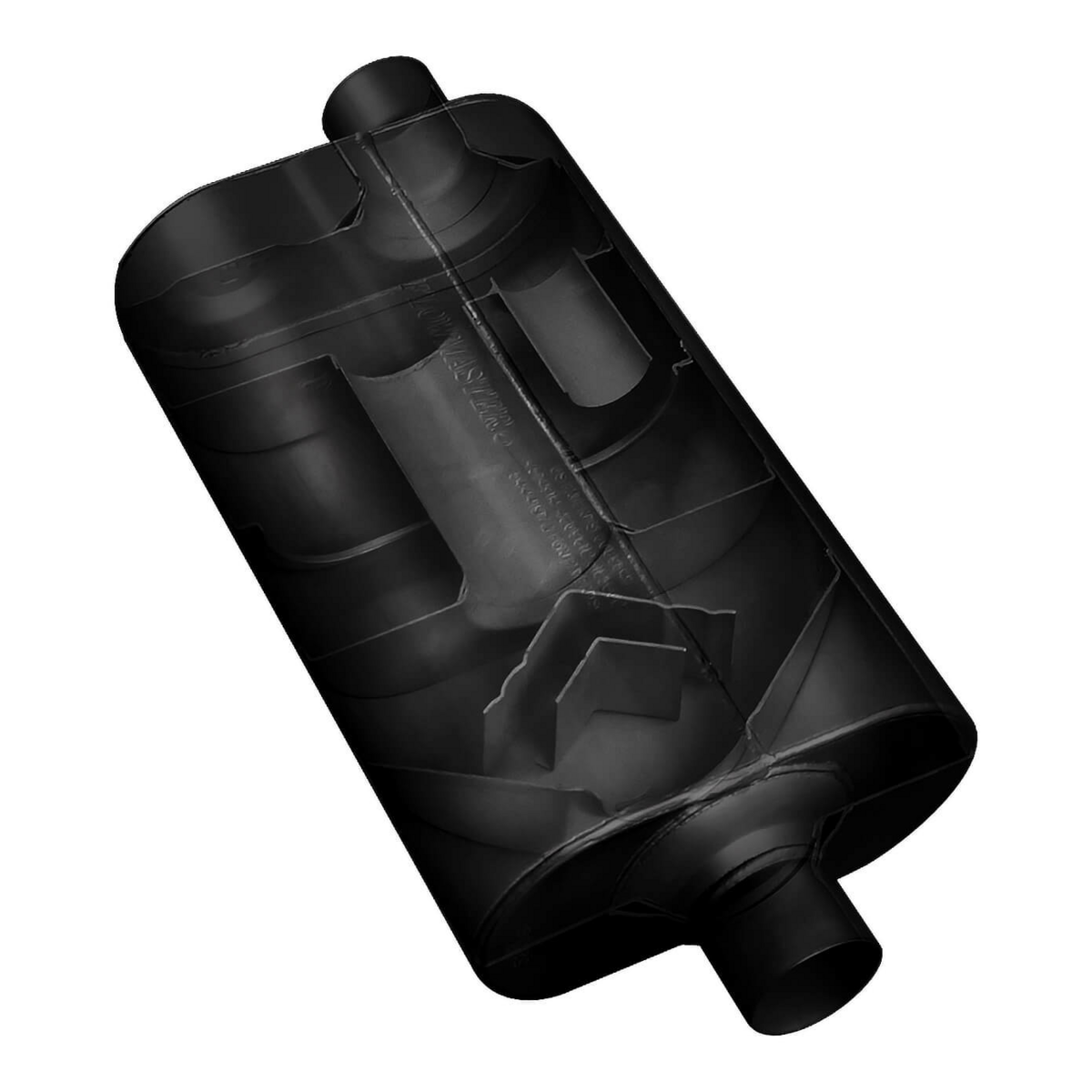

Here is the muffler I used
I like that cutaway of the muffler. I've seen it before, but I hadn't noticed that the middle half is a dead space with no airflow in it. That's a chamber made to reduce sound, like a Helmholtz chamber which is in most OEM mufflers. I'm hoping I can make something myself in a small container to be a sound reduction "resonator."
That muffler cut away, appears the dogs chased the cats and blew the packing right the **** out the muffler!
Ha Ha
9lbs of boost will do that! Your rig once sucked, then got boosted, and now is more Blown and even less sucky!

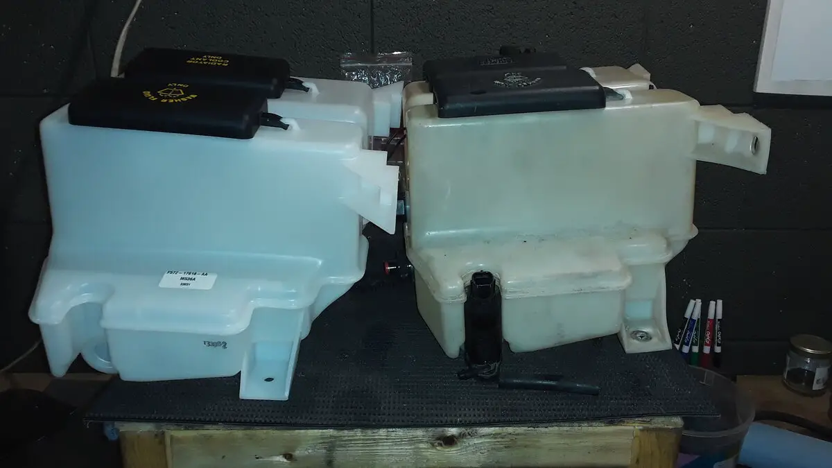

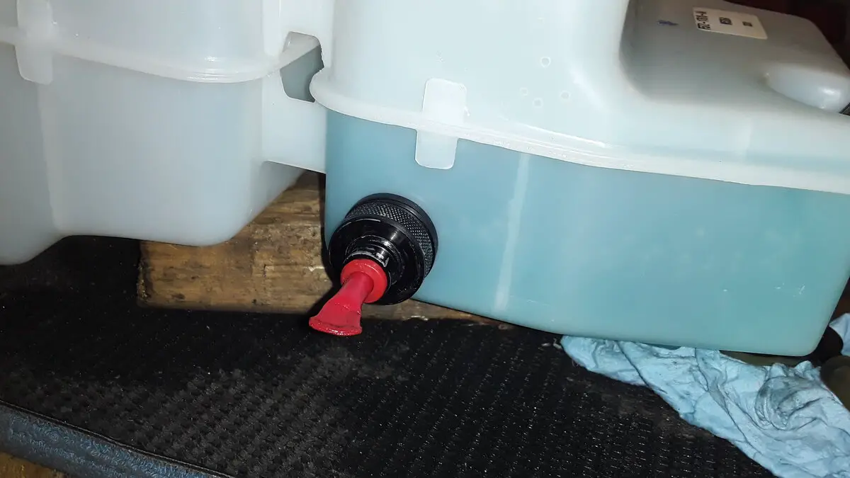

I didn't like the location that I put the float
For the meth supply
I ordered a Motorcraft tank took forever
No leaks
Very nice, a color that you can tell the WW fluid is blue. One of mine looks kind of purple from a distance.
