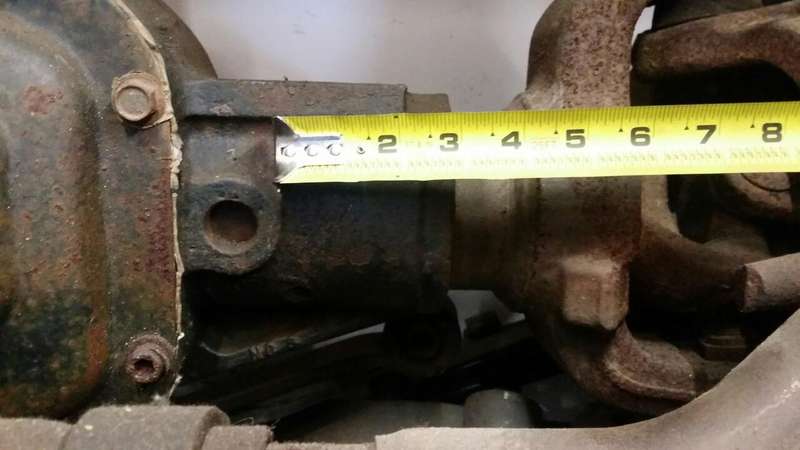

I'm looking to do a SAS on a 2nd gen explorer or sport trac (I have both to choose from at the moment). I already have a D50 from a 02 Superduty is complete in great shape minus some locking hubs. I have always figured I would use a cut down or narrow d44 but I already have this. I would match it in the rear with a 10.5. The plan is for 37-38" tires on some super offseted wheels so they don't stick way out there. It would be on leafs and i would try to keep ABS also. My use would be mostly mud and some street driving so it has to be street legal.
Basically I'm looking for someone to say hey' I wouldn't use it because of so and so. I know all about the axle and it's strengths, but am very unsure of trying to use it under an explorer.
