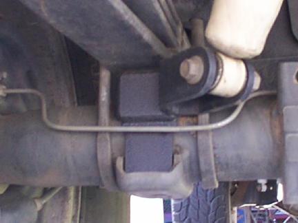

Can anybody running the Superlift 5.5 inch rear relocation bracket show me a pic of what it looks like? The info here says the rear uses stock length shocks with this bracket. I guess my real question is, is this just so you can use stock length shocks, or is there some other reason the bracket needs to be relocated? Seems to me you would be negating a lot of axle travel by sticking with the stock length shocks.
Aw, okay. So the lift comes from a SOA and a block, yeah?
that is the SOA/block. With that installed it lifts the rear ~6 inches. It also provieds the shock mounts. As for your question about the amout of travel being limited by your shocks. It may be slightly limited on the downward side. I have not found myself having up travel hindered by anything other than my 33" tires rubbing the inside of my fenders. Remember you still the stock springs and they flex the same amount wether the axle is over or under the spring pack. Up grading your shocks on all four corners is advised.

is that pic of a 5.5 superlift or the skyjacker 6? Im looking at getting the skyjacker 6 and am unsure if either of them convert the back to a spring over?? Also do either of them require driveshafts to be lengthened or any other mods that are not part of the kits???
The Spring Over Axle (SOA) conversion kit is available by itself at www.4wheelparts.com. The part number for this item is SUP1160 and costs 109.99 + tax. This part is from Superlift and is sold as part of there 5.5 inch lift kit. The kit includes the 2 spring perch blocks, new shock bolts, and new extended sway-bar end-links.

Skyjacker offers no way to lift the rear of your explorer to match the 6 inches of lift they sell for the front. You can however do a SOA for around 40 bucks. If you are a good welder or have a hook up for a welder/welding shop, just get a set of spring perches. Do your pinion angle and weld them on, then move your shocks to the top hole on your sway bar bracket.
