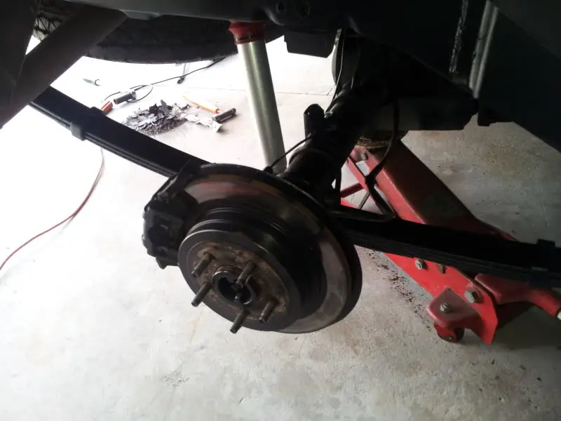

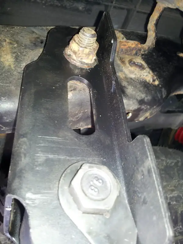

Removed both rear springs tonight. I was rolling along until I got to upper shackle bushing. I'll work on that tomorrow.

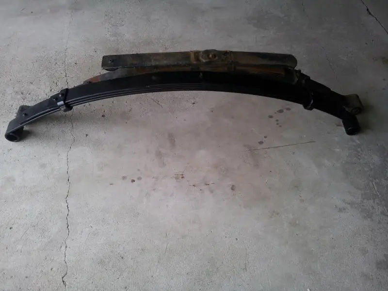

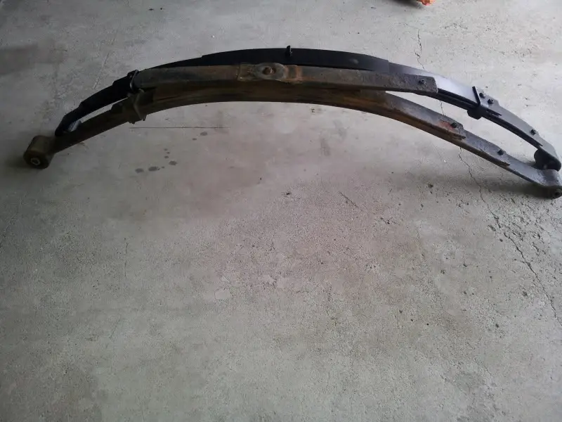

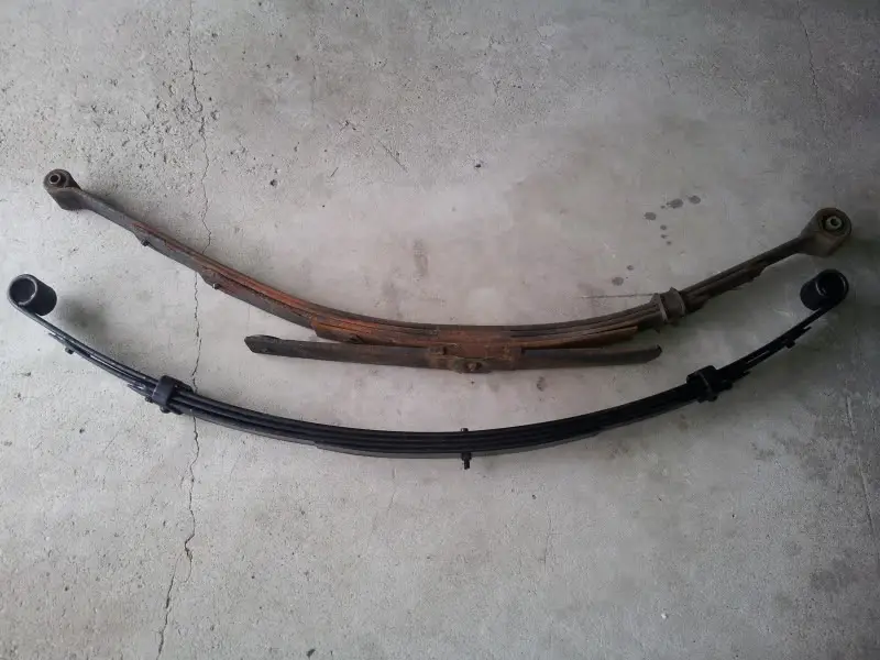

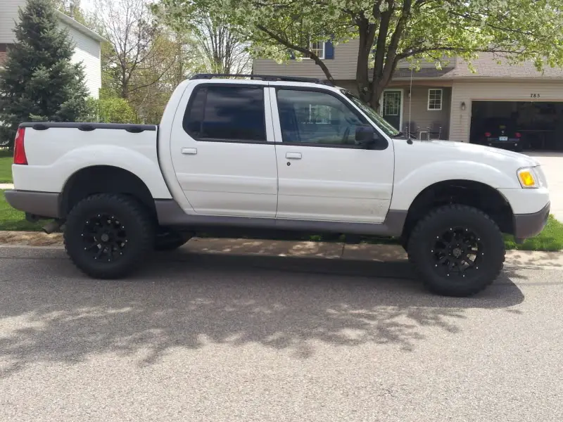

I removed the 2nd leaf from the Superlift springs and re-drilled a hole 1" lower for upper bolt to frame. I test fitted the drivers side. It's 2" higher than my old leafs. Old leafs did have an add a leaf, but they had the classic w profile, after pulling enclosed trailer for 4 years..
Here are some pics to compare stock vs. superlift.
part 2 tomorrow...
